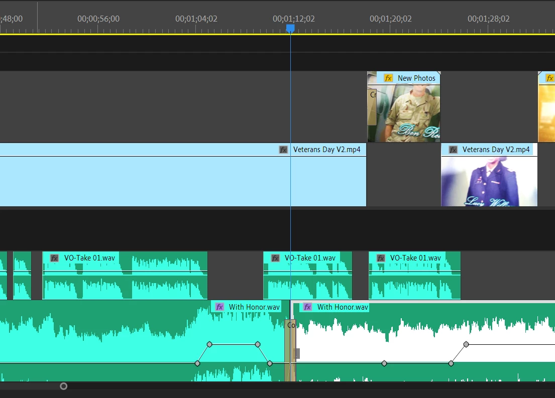

I have a music track that I've cut in order to extend the length of it for my video.  I used Audio Ducking in combination with the VO. However, at the point where the crossfade transition happens, in the exported video, the audio turns back up as if no ducking were applied.  Then when it gets to the point where the next keyframe is, the audio drops back down to that level and matches the keyframe volume as it increases.  It won't always play back that way in the editor, but it always exports out that way.  The one workaround I found is to cut the 2nd clip about a second after the transition, then remove the Amplify effect that was applied from the Ducking, and change the Volume Level to match what the Ducking had applied (in my case, -24db).  I've had this happen on other projects, but it finally got annoying enough to post about it.
I'm glad to provide any info that might be needed.  I'm using PPro 15.4.1 on Windows 10 Pro.  This occured when exporting as H.264 both directly from PPro and Media Encoder.  It also happened when exporting the audio directly as a .wav file.  And this has happened on at least 2 PCs that I've used.  Thanks.

I opened the project in PPro 2022 and rendered it out, and so far there's no issue.  Let's hope it stays fixed.  I'll follow up if something changes.  Thanks for all the help.

another possible workaround would be to put the incoming audio clip on a different track with appropriate overlap on both clips and apply a audio dissolves to the outgoing and incoming clips.  If that doesn't work, keyframe the audio levels rather than applying audio dissolves.  Make sense?  if not, post back and I'll try and do a better job of explaining after my morning coffee kicks in.

That workaround is also a good idea, thanks for that.  But the idea of keyframing the levels, while it would probably work, defeats the whole point of audio ducking.  Or are you saying to keyframe the audio levels in addition to the ducking keyframes?  If so, that might work.

keyframing on top of the audio ducking...
And although premiere is pretty amazing in the way it can usually deal with almost anything you throw at it, there have been reports of issues when you're mixing sample rates...  (although I don't recall any posts with that issue in the past few years) so I'd try resampling the 44.1 audio to 48k and see if that solves the issue...  and of course make sure your sequence is set to 48k audio...   You might also try creating a new sequence with your desired settings and copying the contents of your original sequence to the new sequence.  Everyonceinawhile, a sequence can get corrupted and cause odd issues...
