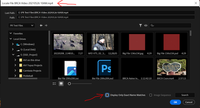

When you click "Locate," you get to this screenshot:

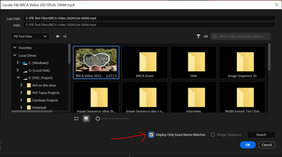

Notice that the "highlighted" file from the previous step is at the top as the one currently being located. To make seeing it easier, make sure that "Display Only Exact Name Matches" is checked.
If this is all good, yes, all files are found and the dialogue window closes. If "Relink others" is not checked, you will be in the previous screen with the one file found (checked) and the next file highlighted.
