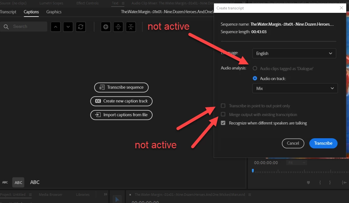

I have adobe premiere pro v22.6.2
according to the image below, the options = (Audio clips tagged as 'Dialogue'), Transcribe in point to out point only, and Merge output with existing transcription are not activeas shown below; what can I do to make all options active, please? The option of the red arrow as in the image below:
In the past, all options worked, and maybe the problem is the version, and I need to reinstall the older one.
Correct answer Stan Jones

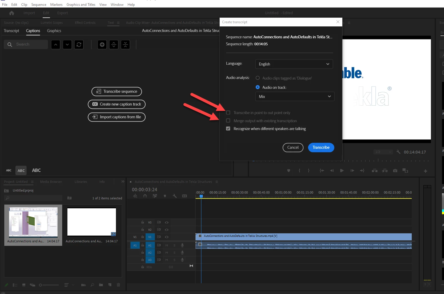

First, I need to thank you so much because you follow my inquiry. This is the entire screenshot. Why are the two options marked with the red arrow inactive, please?
What you see is correct.
"Merge" is only active if you have an already completed transcript. "Transcribe sequence" does not show if you have one completed, so that options will not be active.
After PR 22.5, if you don't have in/out set, you cannot select "transcribe in to out." I can see in your timeline that you do not have these set. So that option will not be active. It will transcribe the full sequence.
Stan

Stan Jones
November 19, 2022
sarmad,
That is odd.
I don't recall any issue with selecting audio as dialogue, unless you did not label the track as "dialogue."
As of 22.5, you can no longer transcribe with in to out if there was neither an in marker nor an out marker. All this means is that you were going to transcribe the whole sequence, so why would you need to limit to in to out. This was to fix a bug reintroduced in 22.0.0. You did not see the bug in 22.0.0 if you explicitly selected both in and out marker.
See this post:
https://community.adobe.com/t5/premiere-pro-discussions/updated-22-4-not-showing-captions-in-timeline-or-text-panel/m-p/13024564#M417897
Stan
sarmad1Author
November 20, 2022
I am immensely thanking you for your reply, but I need you to be patient with me, please, because I am a beginner at that. I need you to have a look at the image below and explain. Why are all options active? While the image above for the latest version are not?The version of adobe premiere is 22.0.0 (build 169) for the image below
Stan Jones
Stan JonesCommunity ExpertCorrect answer
November 20, 2022
Stan
