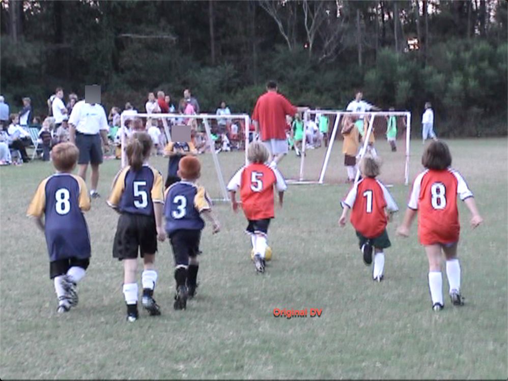

I used Topaz's Dione Interlaced TV Model to take raw 720x480 DV footage of a rec league soccer game and turn it into 1920x1080 HD 60 fps footage. The 60 fps footage has the soap opera effect, but that is what I want from sports/activity video. Here are two screenshots. The original is scaled up in Quicktime Player to match the frame size of the HD converted video.

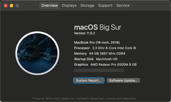

The upconversion process (including doubling the frame rate) ran between 0.13 sec/frame and 0.21 sec/frame on my MacBook Pro.

Jeff, that is an option in the Video Enhance AI product? (About $150 currently?)
Impressive.
