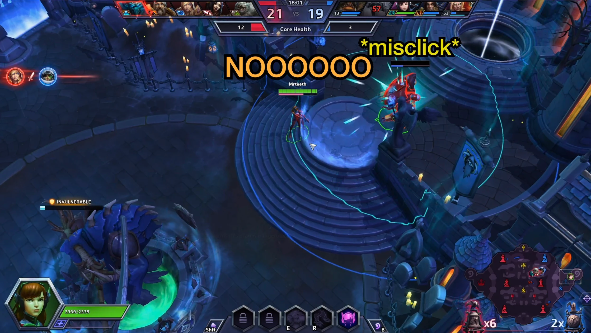

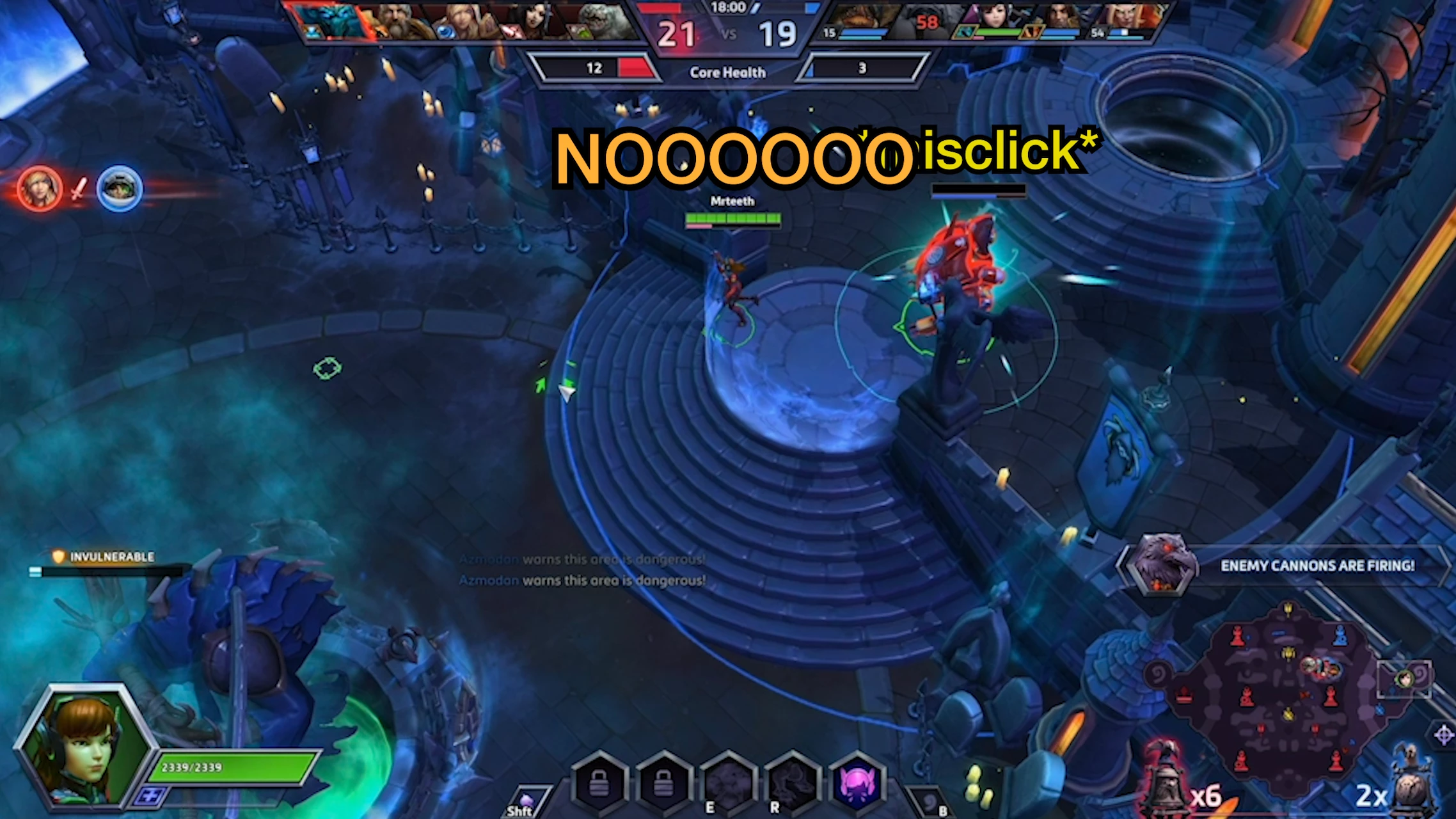

I have an iMac 10.15.4 using a Retina-screen.
I have recently discovered the apparantly quite common problem that the colors when I export my video with H.264 looks "washed out". I'm using Premiere Pro 14.1.
This is how it looks in Premiere, Quicktime and VLC respectively. VLC looks... better. And I've heard that Quicktime is notorious for changing the color of videos. But this extends to the web and watching it on Youtube, both on a Mac and Chromebook, it still looks washed out. Chrome on my Mac looks a bit better, but still not what it's supposed to.
Reading up on this I found a LUT that should apparently fix the problem, making the exported video look like it does in Premiere. The problem is that I have edited with Display Color Management off, and using the LUT makes the video look the way it does with DCM turned on, which is way too dark.
I therefore have the issue with my video getting too bright when I export it normally, and too dark when using the LUT that is supposed to fix the problem.
I just don't know what to do. If I should export in a different format, use another LUT I don't know about or do something else. If this is just because of my computer, wouldn't I want to change it so it will look correct for most people? Or should I just cut my losses? Thankful for any help.
