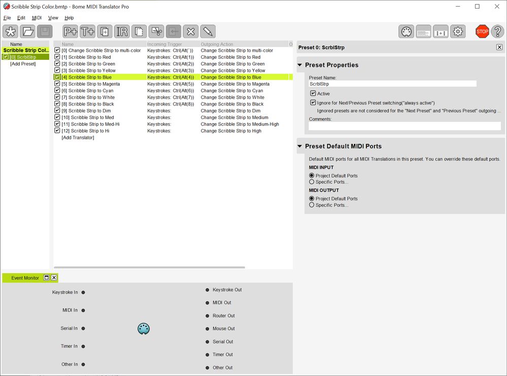

I finished the translators for changing the background color of the LCD scribble strips on a Behringer X-Touch control surface, and I am sharing the Bome Midi Translator Pro (BMTP) file here. If you don't want to download the file, here is a visual reference, which I'll use to explain what it is doing:
First, the main window where default MIDI inputs and outputs are selected. Not shown here is the installation of a Bome Virtual MIDI Port. I used Bome's VMP because it came with BMTP, but there are a bunch of VMP's available. In Default MIDI Ports section, notice the italicized label for "From X-Touch 1 -> X-Touch 1" - that is an alias for the X-Touch. Using an alias is recommended, but I don't recall why:
Then, if you click the Preset in the far left column, you'll see the Preset page:
And for the tranlator itself: the "Incoming" is the trigger for this translator. I set it to a keystroke, [ctrl][alt][4], because the bit code for blue is 04. Here are all the colors and bit codes: Red=01, Green=02, Yellow=03, Blue=04, Magenta=05, Cyan=06, White=07, Blank=00. So I chose [ctrl][alt][1 thru 8] as the shortcuts for color, but it could be any key/modifier of your choice.
The color change is accomplished by sending a sysex (system exclusive) message to the X-Touch. Bome is used to interpret a keyboard shortcut into this sysex message which Bome then sends to the X-Touch. There are no rules for this translator.
So the sysex message itself and what it is saying to the X-Touch:
F0=Hey, here is the start of a sysex message (Sysex message start)
00 00 66=I'm talking to you, X-Touch (Manufacturer, device ID)
14 72=Specifically I am talking to the scribble strip and am going to tell them a color
04 04 04 04 04 04 04 04=Make Channel 1 blue, make Channel 2 blue,...make Channel 8 blue (color bit)
F7=Over and out (Sysex message end)
Unfortunately, I have not been able to make translators 9 thru 12 to work. They are supposed to change the brightness of the scribble strip but so far have not worked.

Here's a detailed guide for setting up Bome MIDI Translator Pro (BMT) to change the scribble strip text on Channel 1 of the X-Touch when the [EQ] button is pressed, using B0 4B 05 as the trigger:
Step-by-Step Configuration:
Step 1: Create or Open Project
  • Open BMT and ensure you're in the correct project or create a new one if necessary.
Step 2: Verify MIDI Routing and Aliases
  • Your setup already has the correct aliases and MIDI routing:
  • MIDI IN: "From X-Touch 1->X-Touch 1"
  • MIDI OUT: "To X-Touch 1->X-Touch 1"
  • MIDI Router: "Bome Virtual Port 1" to "To X-Touch 1" and "From X-Touch 1" to "Bome Virtual Port 1"
Step 3: Create a Translator for Scribble Strip Text Change
  • New Translator:
  • Name: "Change Scribble Strip for EQ Mode"
  • Incoming Message:
  • Type: Control Change (CC)
  • Channel: 1
  • Controller: 75 (hex 4B)
  • Value: 5 (hex 05)
  • This corresponds to B0 4B 05
  • Rules:
  • Here, you might not need rules unless you're doing conditional checks, but if you want to ensure this only happens once per press, you could use something like:
  • if g0==0 then goto "SendText"
  • g0=1
  • Label "SendText"
  • g0=0 (after sending, reset to allow for another press)
  • Outgoing Message:
  • Type: System Exclusive (SysEx)
  • You'll need two SysEx messages for the upper and lower lines of the scribble strip:
  • Upper Line ("NAVIG"):
  • F0 00 00 66 14 12 00 4E 41 56 49 47 F7
  • Lower Line ("<- ->"):
  • F0 00 00 66 14 12 07 3C 2D 20 3E F7
  • In BMT, you'll set these up as:
  • SysEx 1:
  • Data: 00 00 66 14 12 00 4E 41 56 49 47
  • SysEx 2:
  • Data: 00 00 66 14 12 07 3C 2D 20 3E
  • Make sure "Send F7" is checked for both SysEx messages to properly terminate them.
Step 4: Set up the Output
  • Ensure that "To X-Touch 1->X-Touch 1" is selected in the Outputs for this translator so that the SysEx messages are sent back to the X-Touch for display update.
Step 5: Test the Setup
  • Testing:
  • Press the EQ button on the X-Touch and check if the text "NAVIG" and "<- ->" appear on the scribble strip for Channel 1.
  • Use BMT's MIDI Monitor to see if the messages are being received and sent as expected.
Step 6: Save and Finalize
  • Once you confirm the translation works, save your BMT project. You might want to organize this translator into a specific preset or profile if you're managing multiple configurations.
Notes:
  • Echo Management: Since your setup routes "Bome Virtual Port 1" back to "To X-Touch 1", ensure that this doesn't cause an echo of the SysEx messages. If you see repeated messages or unwanted behavior, consider filtering or conditional rules to prevent this.
  • Alias Management: The italic entries in your MIDI setup suggest they are system-managed or locked aliases. This is normal and indicates they're internal to BMT's routing system.
  • Documentation Reference: The SysEx commands for the X-Touch are based on the MIDI Implementation document provided earlier, particularly where it describes how to change the display text.
This setup should now change the scribble strip text for Channel 1 whenever the [EQ] button is pressed, using the specified MIDI message as a trigger.

slovill
slovillAuthor
Feb 12, 2025 7:33 PM UTC
The encoder assign buttons - if they can be utilized - the first two are utilized by Premiere Pro already - the TRACK and PAN/BALANCE assignments, with the PAN/BALANCE assignment being the only one that actually change something in Premiere Pro. The EQ button lights up, but the encoders have no apparent function. It would be cool to have the EQ assignment button set up control of the track effects in the audio track mixer, the SEND assignment button set up control of the Effects Controls panel, the PLUG-IN assignment to control the Properties Panel and the INST assignment to control the Lumetri panel.
Anyway, here's a start from Grok:

slovill
slovillAuthor
Feb 13, 2025 4:48 AM UTC
The latency introduced by the several software layers required to make MIDI inputs something that ExtendScript can understand and transmit to Premiere Pro is unacceptable. Instead, using the SDK to write a custom plug-in would be the way to go, but I don't have the chops for that. Maybe somebody who can code will have a similar idea someday.
In the meantime, I'm just going to use Bome MIDI translator to do a simple version. Here is action=keystroke=control surface list.
Navigate to and select values in selected panel = [TAB],  [SHIFT][TAB] = Encoder knob 1
Change selected value (coarse) = [SHIFT][UP ARROW], [SHIFT][DOWN ARROW] = Encoder knob 2
Change selected value (normal) = [UP ARROW], [DOWN ARROW] = Encoder knob 3
Change selected value (fine) = [SHIFT][UP ARROW], [SHIFT][DOWN ARROW] = Encoder knob 4
Here is one answer from Grok about how this can be done. Note: replace example keyboard shortcuts with your choice. I've not tried yet, but will add a post later with results:
Prompt:
can you help build a practical example in Bome MIDI Translator Pro that would keep normal function for the X-Touch encoders when the encoder assign selected is 'track' or 'pan/balance'; but when the 'eq' encoder assign is selected the encoder output changes to a keystroke instead of their normal function. This will be for integrating keyboard shortcuts in Adobe Premiere Pro.
Response:
Here's a practical example for Bome's MIDI Translator Pro to handle the integration of keyboard shortcuts in Adobe Premiere Pro, specifically for when the X-Touch's encoder assignment switches to 'EQ':
