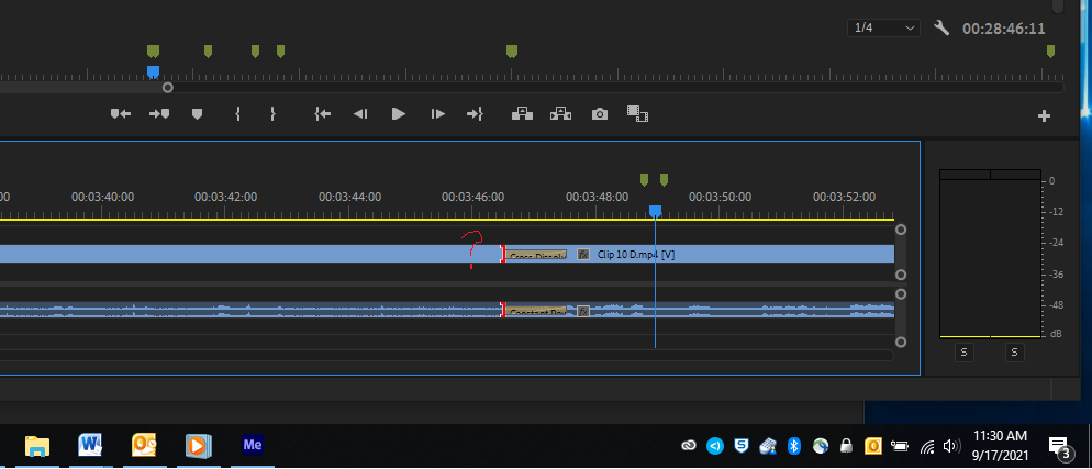

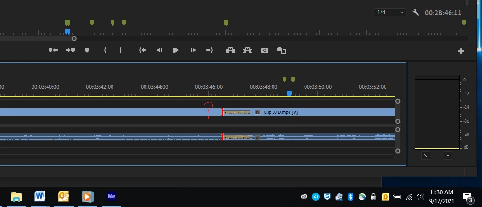

Usually cross dissolve works just fine and overlaps the two clips I'm trying to transition, but for these two clips it seems to only want to be on the clip to the right. Any ideas on how to get a proper transition? All help appreciated.

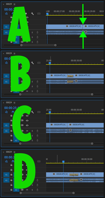

I´ll do my best. It does not matter if the media has 4 or 400 minutes of media. The important thing is how much of that media are available for the transition. If you place two clips on the timeline, butt to butt, you must trim of some frames from the end of the left clip and some frames from the start of the right clip, frames that are needed for the transition. The amount of frames must be as long or longer than the transition itself.
In image A you can see that i have two clips and that the right clip has two white "dog ears", indication that the start of the right clip has not been trimmed. The clip to the left does not have those "dog ears" indicating that the clip has been trimmed/shortened. Image B shows how it will look if i place a transition between those clips.
Image C shows the same clips but this time i have trimmed off some frames from the start of the clip to the right with enough frames to make up for a transition. If i now apply the transitions you can see how it looks in image D.
So, if a you want a double sided transition that is 24 frames long, you must trim off at least 12 frames from the end of the clip to the left and 12 frames from the start of the clip to the right. (12+12=24) If you for example only trim of 24 frames (or more) from the clip to the right you will see what you see in image B.
This means that if you trim off some frames from your clip to the right using Ripple Delete or manually close the gap between if using the Selection Tool the transition should work. Now you should be able to move it and center it between the clips with your mouse.
Did that make any sense? 🙂

Hi Mr. Gerikp,
The clip to the left has nearly 4 minutes of media, I'm not sure how it doesn't have enough media. Could you explain further? I appreciate all the help. 🙂
