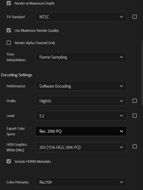

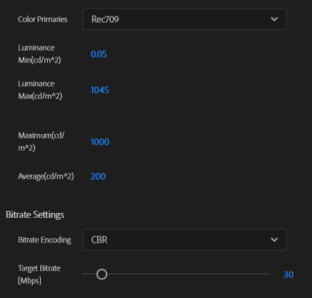

So i've imported all my mobile phone footage, set the sequence color space to Rec. 2100 PQ just like the footage and i export the sequence and it looks terrible.
These are my export settings:
Screenshot 2024-03-03 141434.pngScreenshot 2024-03-03 141501.pngScreenshot 2024-03-03 141509.png

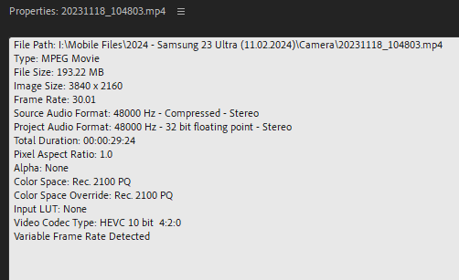

Properties of each file:

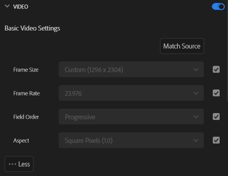

You aren't fully setup in your CM from front to back.
So ... it would be helpful if you included screengrabs of the entire Lumetri Settings tab ... all the color management settings. Project, sequence, display, everything.
And of course, if you are working in any color space,  you must also use an export preset built FOR that color space!
So your export preset looks like you started with an SDR/Rec.709 preset, and tried to turn it into HLG, but you missed a couple things. Instead, START with a preset that matches your sequence. Which means that any HDR work needs to use a preset with that form of HDR in the preset name. For your situation, it should say HLG in the preset name.
