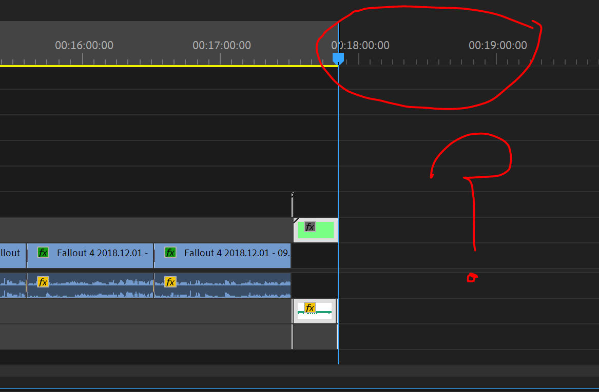

Once again I am getting rendering / encoding issues. They are really bad this time. I can't render any video at this point, it keeps kicking out the error compiling video (see below) - The biggest issue is that it is giving me errors for a timestamp that does not exist!!! (also see below)

Timestamp does not exist:

This must be a 60fps timeline?
The error is at 18 seconds, 35 frames - not 18 minutes.
Timecode is always HH:MM:SS:FF.
MtD

I called on my friends to assist me further, most of them in the industry, many of them I worked with on 48 hour film festivals. They gave me some ideas.
The first idea was to export the "error zone" as they called it using the alternate non GPU acceleration. Holy crapola it worked! It took 9 minutes 3 seconds. My estimations, it will take 2 hours 27 minutes to render a 19 minute video that normally took 14 minutes to render. Thats not an option.
But I brainstormed further, and after taking an aspirin, I took that rendered video, and replaced it in the "error zone" as I am now calling it replacing the evidently too complex sequence, and it finally exported that section without an error. (This is the timestamp area where the errors keeping generating from)
It worked! I am now in my 2nd video I have to render and so far * knock on wood * its working.
It comes down to this, coming from people in the industry, and above my pay grade. The complex text editing I did was too much for Premiere's antiquated encoding program to handle. I should be using AE for that type of thing. They had no argument that Premiere should be able to handle this. None of them had any answer for the fact it rendered 10+ times before, but all of a sudden just stopped working. That is the most frustrating thing about this...
