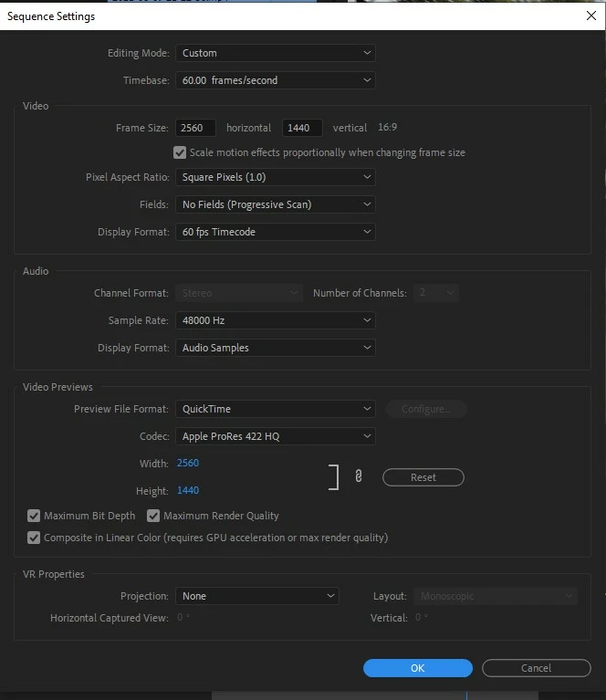

Hello, my name is DJ and I've ran into an issue that many people face when it comes to exporting videos. The problem at hand is attempting to retain lossless quality while not bloating my filesizes to the moon. Is that even possible? Like keeping it around the same filesize as the original file?

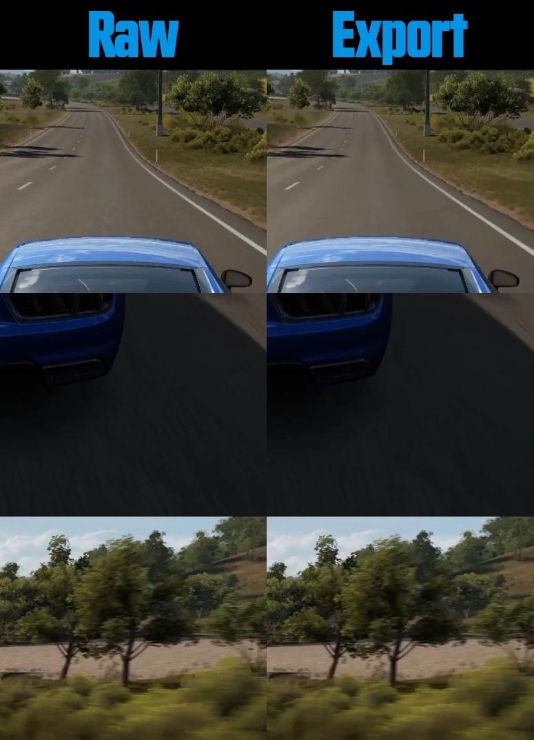

I've been wanting to chop up my raw video files that I've recorded to be reused in future Youtube videos, but most exports seem slightly blurry when you compare them to raw footage. It's like I lost data and a lot of sharpness. I've attempted a few different codecs like Quicktime + ProRes422/ProRes4444 and those bloated my test file towards 4-5GB's compared to the raw 359MB file.

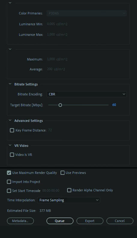

At this moment, I keep going back to H.264 because so many Youtubers use this for rendering video game footage and there's got to be a better way. I've attached the current export setup that I'm using and you'll notice certain areas was lost in the export as well. The most noticeable areas are around the pavement, either in front of the vehicle or shadows near the rear bumper. I want to keep that data on the road as much as possible please.

@Averdahl - There is something I should mention. Everything I've showed in those screenshots isn't the normal settings I use to render my usual videos, most options that are checked or selected are there to see if anyone mentions anything different. I run Maximum Bit/Render quailty off, Software encode and Key Frame Distance to 30 already.
I've attempted almost everything you've mentioned inside Adobe software before making this thread like Maximum Bit Depth/Render Quailty, Hardware vs Software encoding, Key Frame Distances and every codec Adobe gives you straight out of their software. It's been a multiple year guessing game when I think about exporting full length videos or small video clips.

I would skip Maximum Bit Depth and Maximum Render Quality and switch the Hardware Encoding to Software Encoding and lastly under Advanced Settings change the Key Frame Distance from 72 to 60 or even 30.
  • Maximum Bit Depth and Maximum Render Quality do not create the best quality in all situations.
  • Hardware Encoding do always look worse than Software Encoding.
  • Key Frame Distance at a lower value creates more I-frames = Better quality.

Unfortunately H.264 will never give you lossless quality.

H.264 is pretty much always going to give you this issue, even at high bit rates as it will be creating new keyframes in different places from the source.
You might want to take a look at Shutter Encoder and use the 'Cut without re-encoding' function. It will only let you cut on keyframes so it might not trim to exactly the frame you choose but it won't do any re-encoding so it will be fast.
