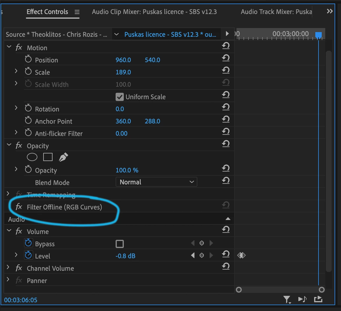

I recently updated Premiere Pro to version v22.0.0 (Build 169)
When I load existing projects, any instance of the RGB Curves filter is now listed as Filter Offline (RGB Curves) in the effects panel, and the filter is non-functioning.
This means that a lot of color correction in existing projects no longer works. This is obviously VERY inconvenient! I tend to use the RBG curves filter for quick adjustments because it renders much faster than Lumetri. I can on longer make tweaks to existing edits without checking and fixing every clip that had the filter applied.
It seems odd to me that a filter would be disabled/offline. In other updates I've seen an "obsolete" label added, but the filter is still functional.
Is there a problem with how my update has treated the filters? I haven't had an "offline" error with any other filters.

Are you on an M1 Mac? I know on those, some of the "obsolete" effects are gone.
Actually, anymore you should be able to get the same performance if you just use the Lumetri Curves tab as you did with the RGB Curves effect. I can't tell any difference whatever in playback.
