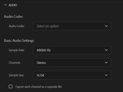

It seems very odd since audio not have a frame rate, so it never matters. One second audio is one second at any frame rate so mixing frame rates should not matter. Different bit rates do often cause issues though. I see that one camera is set to 24-bit while the other is set to 16-bit.
One simple test you can do is to place the 50p footage on a 50p timeline and render out the audio to 16-bit/48Khz and import that audio while muting the original audio and see if that new 16-bit/48Khz audio behaves better. It´s often enough to render out 30-60 seconds to try it.
