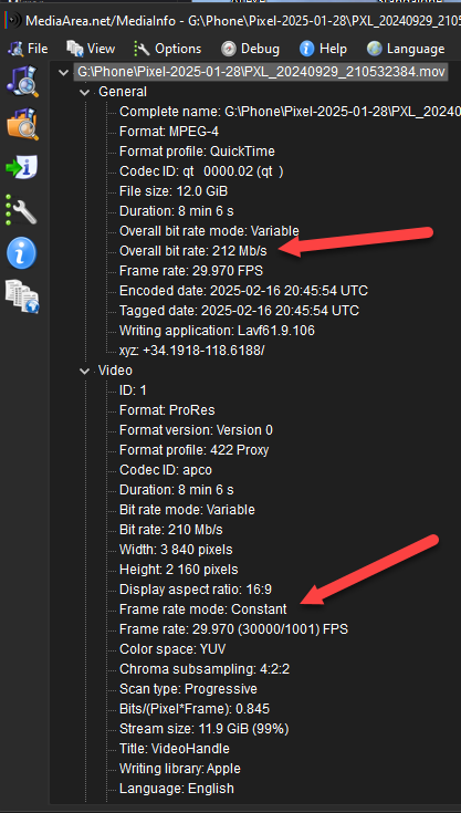

It's assumed you've got CFR set in the Shutter Encoder prefs.
Now you need to post a screenshot of MediaInfo in Tree view, similar to the one I posted above.
You can use the free MediaInfo program to get info on your clips. Get the program from the link below and using the 'Tree' view post a screenshot of your clip info: https://mediaarea.net/en/MediaInfo/Download

BTW: The ProRes proxy is about 4 times the bit rate of the Pixel file, so I think that's enough.

I just tried an 8.06 pixel file into SE to ProRes Proxy and the lip sync seems good. How long is your clip?
Original
ProRes Proxy

What's the framerate set to in your Pixel? If it's 30, then I think your 2nd test is valid, but if its 24, then, I would try again, leave the preference "Set framerate mode" to CFR always. Never think about it again! 🙂
Try in Advanced to Conform by... and 24.
A mediainfo in treeview of your two files would be great.
From my Pixel Pro 8 I get of course 😞 VFR, when I transcode it I often use ProRes 'Proxy' as that most closely matches the bitrate coming from the Pixel.
