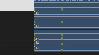

Hello, I am not sure what I pressed but now these green markers have appeared inside my clip and I was wondering 1) how to remove them and 2) what are they for?

You hit the M key while the clip was selected. Which created a Marker. If ... without moving the playhead ... you'd hit the M key a second time, the Marker's dialog box would have popped up, where you can name them or make a note in the description area. Set a color, so you can have markers for various purposes or people.
A marker is a ... mark. To tell you or someone else something. A way to store notes.
You can use commands to go to the next or previous marker, or you can open the Markers panel, and even navigate to places on the timeline by selecting a marker. You can read the notes for that marker.
And of course there are commands to delete markers also.
Using the Help menu, get to the Manual and check the section on markers. Very useful tools.

ahh thank you, I didn't realize you could marker individual clips as well. I kept clicking away from the clip and hitting the clear all markers shortcut and was confused on why they didn't dissapear.
