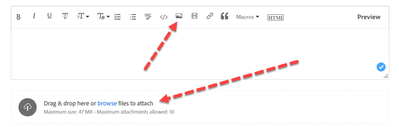

Please use the forum for your screenshots; non of them work in any post.

Jun 30, 2022 Jun 30, 2022
How come they don't work? They're links to an image uploading site. Others see them.. I don't understand 😕
quote
By @Ignas5EAA
Please just do as asked.
Explorer ,
Ok, next time I will upload images straight to here.
