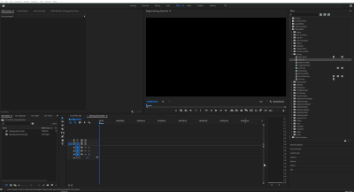

I have a short timelapse video of a storyboard being drawn out.  The artist used a green marker first to lay things out and then drew over those lines in other colors to create the finished piece.  I've tried using color key and ultra key, which resulted in a black line instead of green, and ultra key and resulted in a red line.  I'm guessing that this is pilot error, but I can't figure out where I am going wrong.  I've attached screen shots to help.

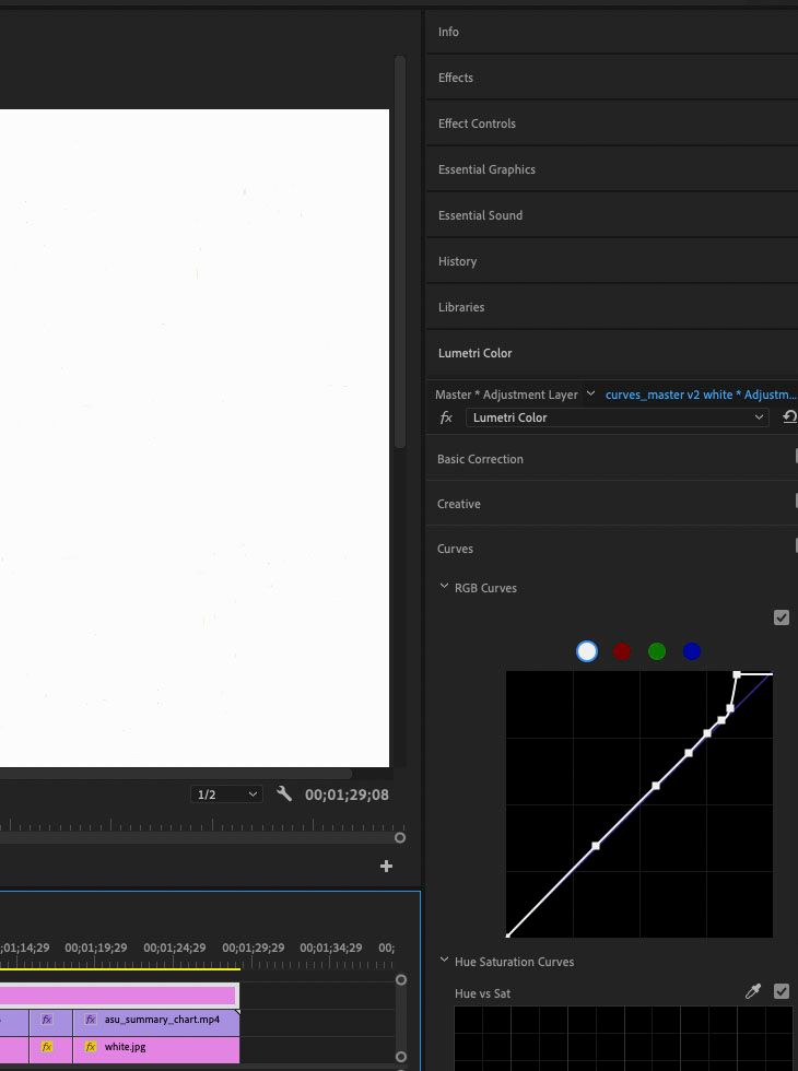

January 11, 2021
I've attached a few screenshots of what happens.  I identify the color (magenta) in Ultra-Key, but there is still grey whereever the color was, even though there is a pure white layer below.  I solved it by adding a curves adjustment layer in Lumetri, but it hurt the pastels in and around the clouds and mountains.
Is there something I am missing here?
Expand the Matte Generation under the Ultra Key, and adjust its parameters to get a better result. Also play around with the Matte Cleanup parameters, you'll understand how they work when you start adjusting them.
