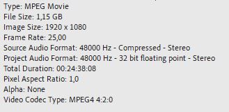

Hello dear members!
My family created many homemade videos in the past which are just series of clips in video files.
I would like to stabilize those shakky videos however Adobe Premiere Pro makes them very slowly.
I tried to use "Scene Edit Detection" function to split them again and apply the "warp stabilizer" individually however the program goes crazy and makes it very slowly. I do not have the original clips anymore, so that's why I need to do something with the edited long videos.
Could you please suggest me ideas how to stabilize those videos?
Thanks in advance!
Marco
October 23, 2022
Thank you all for the useful comments!
I got your main points, I am aware that stabilization is not an easy job. However I had very good experiences with it from the past when I edited my 4K individual clips into a movie. I have never ever had problems runnig wrap stabilizer in parallel and it used all my 12 cores 100%. I never try to stabilize very shakky, fast etc. videos, I want to compensate some hand shake only.
However now when I have an edited long movie (it is only 1080p!) and I need to split to separate clips the wrap stabilizer works completely different. I cannot run in parallel (if I put 2 wrap stabilizer at the same time it slows down like crazy) I need to put them one by one and it does not even use 30% of my CPU resources.
So actually I am just curious why it works in a different way.

My problem is that when I put random individual clips to the timeline and put warp stabilizer then it runs very fast and on multiple CPU cores. However if I use Scene Edit Detection and split the long video into pieces and then apply the warp stabilizer it behaves completely different (very slow and no multicore).

October 22, 2022
For scene detection, I assume you are "cutting" and not just marking. True?
What are your sequence settings (primarily resolution - SD, HD)? Do they match the clip properties?
My quick test, this is still very fast, but I was using very easy  material, and the scenes are short.
What are your computer specs?
Stan
