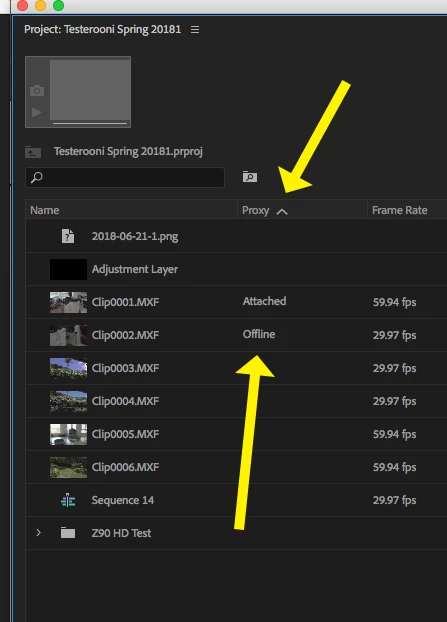

I know about the proxy toggle icon, but is there a way to confirm that Premiere is using the proxies? I had an issue where the application forgot where my proxies were, and now I'm having serious performance issues, and I want to be sure that proxies are indeed being used when I toggle the proxy icon, any suggestions?
Correct answer Meg The Dog
In your project panel list view, add the Proxy column to your Metadata display;
That will show you if the proxies are online and attached or offline.

June 22, 2018
Meg The DogCorrect answer
June 22, 2018
MtD

jimtronAuthor
June 23, 2018
Actually, Meg, I'm on PPCC on Windows 10, and I don't see a "proxy" metadata field, like in your screenshot. I have "proxy file path" and proxy media file name," but neither of those show attached/offline status. Are you using a different version?
