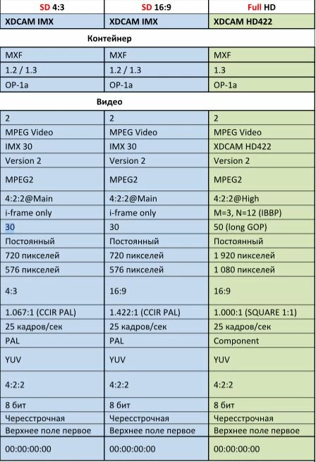

Good day, community! I have a question that may seem silly, but I'm not sure, that I correctly understand the video instructions for the TV format, for the following requirements:
  1. Format - XDCAM IMX
  2. Container - MXF
  3. Codec - MPEG Video
  4. Codec name - IMX 30
  5. Bitrate - 30
  6. Frame rate - 30 fps
  7. Aspect ratio - 4:3 (720-576)
  8. Bitrate type - constant
  9. Format Profile - 4:2:2

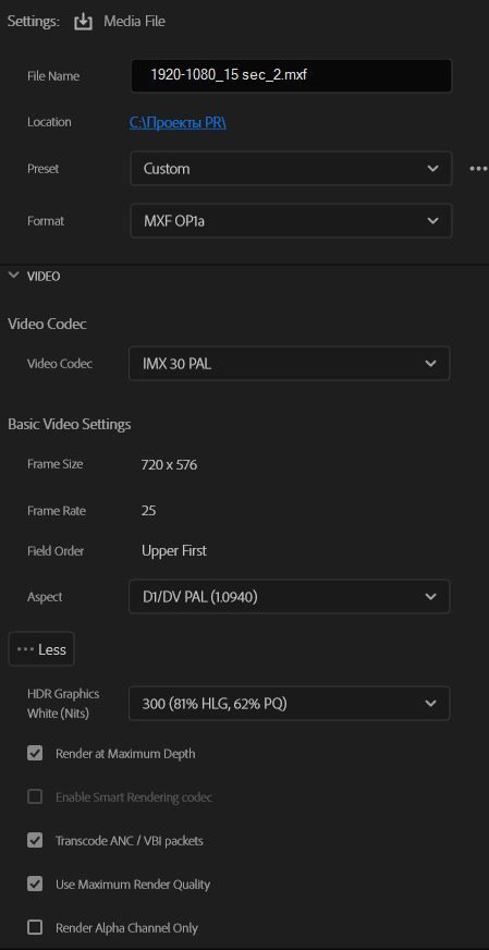

Here is the preset, that I chose directly in Premiere Pro:

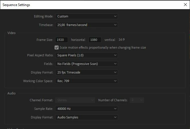

And sequence settings in the project:

Your sequence settings are for HD 25fps progressive and you are exporting at SD quality at 25fps interlaced, both 'PAL' settings. You list 30fps as the required framerate, do you mean 25?
