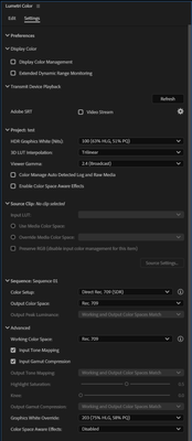

I need clarity regarding the sequence setting for iPhone 16 Pro Max. It is looking over saturated, over exposed and skin tones are bright pink.
In Sequence Settings > Color Management , I am not clear on the Color Setup setting I should use. The options are Direct Rec 709, Direct HLG and Direct PQ. I am using the first one, Direct Rec 709. The Output Color Space is set at Rec 709.
In the Lumetri Settings, what setting should be used in HDR Graphics and is this affecting the saturation and color? What Viewer Gamma should be used, 2.4 Broadcast? Or Quicktime? In Source Clip, I have used Overridew to Rec 709. In Sequence Direct HLG, I have selected Direct Rec 709 (SDR) with Rec 709 Color Space. The Working Color Space is set at Rec 709.

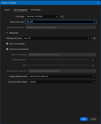

I am not sure what exactly your end target state is, but try this, and see if it moves you closer;
When you create your sequence, or after, chance sequence settings to "rec709".  This assumes you want your final output to be in rec709 (aka youtube or any Target that doesn't support HDR playback.  This preset will change the color output space to rec709 and the working color space to rec709.   If you editing monitor both supports and is setup correct, you can leave the working color space at HDR (or a variant like HLG etc).  Adobe now will properly convert a clip to appear proper on the timeline, and output even if they are different.
I don't bother making any changes in the lumetri settings after I make that one change, its the only change I have ever needed to make to get color space to work properly (assume you are on on the latest version of PP, this didn't work on older versions).
As a side note the timeline clips apparently do not currently work with the color space, only the source and program windows will show proper color space.

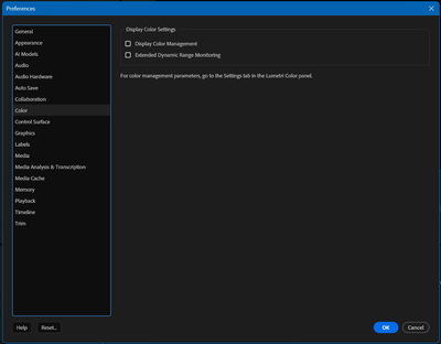

These are the settings that I have when I set the timeline to Rec709:
The preferences for color management I have are:
There might be something minor I am not reading in your original post that I am overlooking,  but I figured having an sample of what works maybe makes its possible for your confirm it matches, and then someone else can maybe add more to help you.
It would however be ideal if you can tell us what the outcome your looking for?  I assumed it was to take iphone HLG2100 clips, and edit in a rec709 workspace and output in rec709 also.    What you described, seems like you have the settings right, but the description of color shift to pink etc seems very wrong - almost like you might be using a HDR display with incorrect HDR setup, but that's a guess on my part.

Fairly simple if you stick with Rec.709/SDR timeline and exports.
Display Color Management on (unless using a calibrated and profiled monitor fed through a breakout device not a GPU).
Extended Dynamic Range on also for Mac users.
Auto detect log and auto tonemapping on, sequence to Rec.709.
Viewing gamma is a tickler unfortunately thanks to Apple
UNLESS you are doing color work in a mostly darkened room, Viewing Gamma should be Gamma 2.2 (which is by the standard and has nothing to do with whether you send to web or broadcast).
Viewing Gamma to 2.4 if working in a semi-darkened room no matter if heading for web or broadcast.
But ... if working on a Mac, without Reference modes set to HDTV, Apple's CM utility will apply an incorrect display transform of 1.96 to video played back in QuickTime Player and Chrome and Safari.TThis lightens shadows a bit.
VLC and Potplayer will show a more correct display transform on the same computer.
So if you only care how it looks on Macs without Reference modes set to HDTV, set the viewing gamma 1.96 option. It will look the same after export in QuickTime Player and Chrome and Safari.
But too dark on that computer in VLC and Potplayer and Firefox, and on all other screens.
