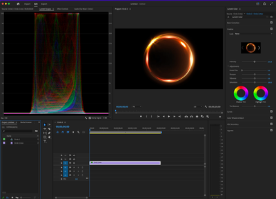

Add a Lumetri Color effect to the clip.
In effect controls select Lumetri color
Go to the Curves section
You should be able to control the extents of the glow by attaching points to the RGB Curves
Have a play around with a gentle S curve to affect the highs ans lows in the gfx image.

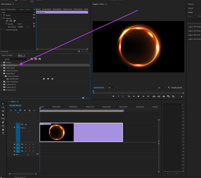

Avidwarp
July 15, 2022
Try this with black background graphics.
1 - select the clip on the timeline
2 - open the effect controls window in the interface
3 - you should see an option to control Opacity
4 - twirl down and you will have access to Blend Modes
5 - select Screen.
Should get rid of black and keep the glow.
