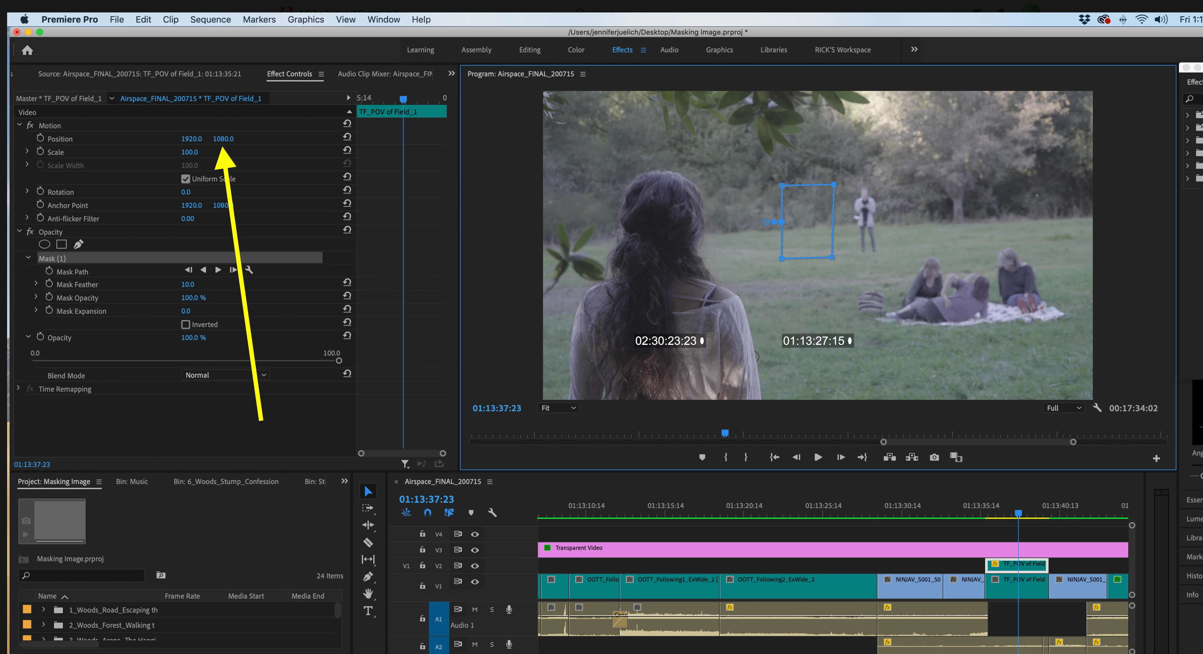

LEGEND , Aug 14, 2020 Aug 14, 2020
With the mask in the first positon, click down on this number and drag to the right (the cursor with change to a icon with two arrowheads pointing left and right):

LEGEND ,
Copy link to clipboard
Copied
Ooops, sorry, I meant the number on the left.
