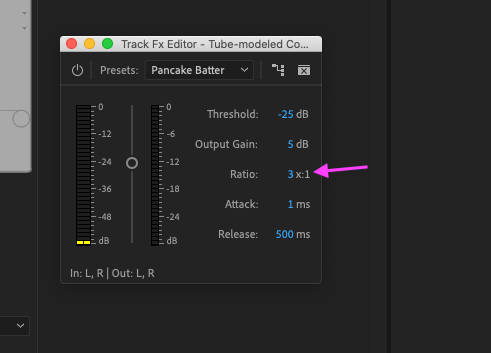

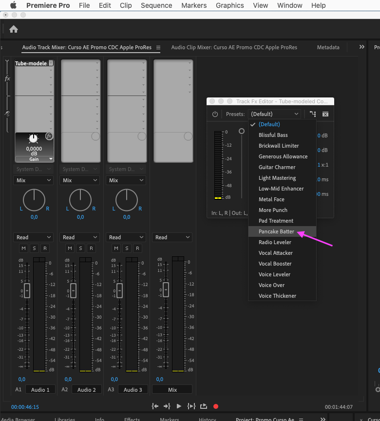

You could try the following:
- Open the Audio Track Mixer from the Window menu
- Unfold the little arrow to be able to insert the effects.
- Apply a Tube-modeled Compressor
- With double click on the name of the applied effect you open it and in the Track Fx Editor window you apply a Pancake Batter effect to it.
- Play around with the settings especially with the Ratio.
- Perform this procedure on each audio Track that you need.
Regarding the levels there are some references such as that the voices can be more or less between -12 dB, the sound effects between -10 dB and -30 dB, the musical tracks could be between -20 dB and -30 dB. These values are not set in stone so it is your ear that should really define the best volume level for your audio clips.
I hope this helps.
