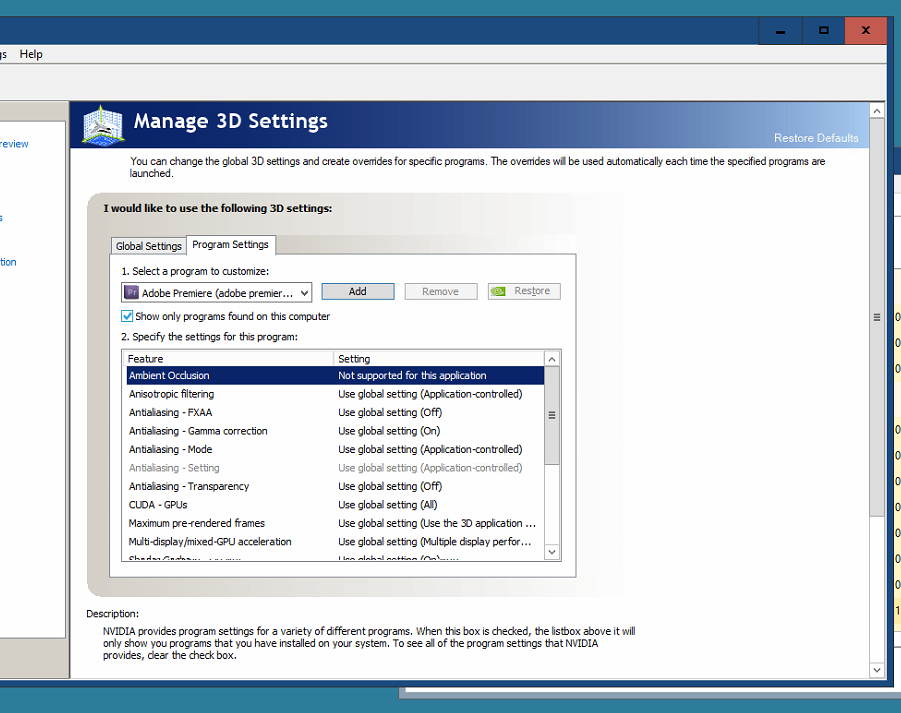

what these settings of Nvidia NVIDIA GTX 260 Graphics Card must be??

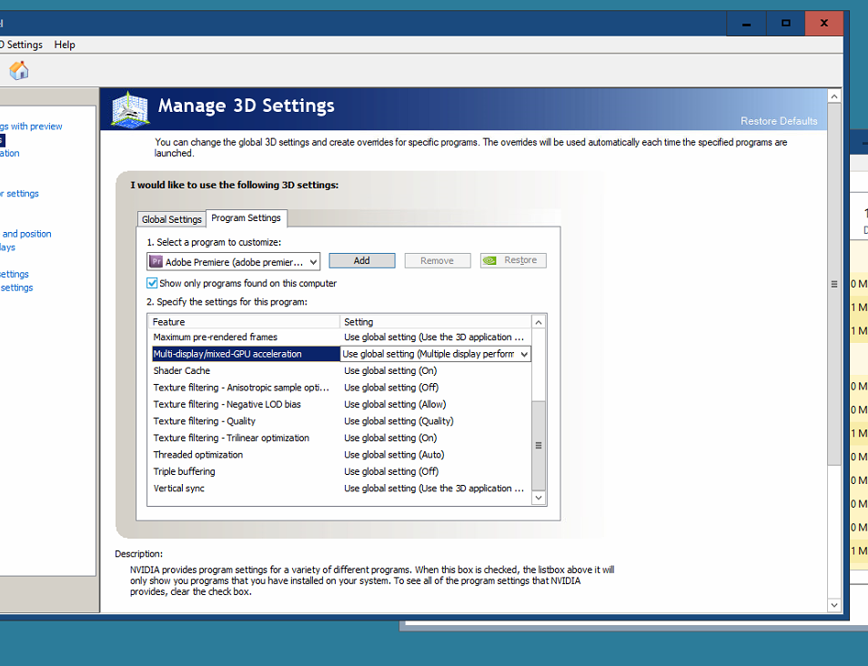

Set nvidia control panel to default.

What set in the first screenshot >>> ?
"nvidia control panel to default."
what set in the second screenshot?
