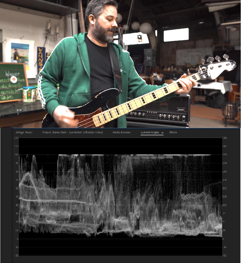

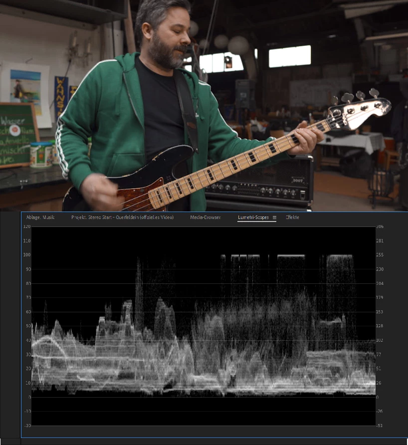

Hey there,
i just finished my colorcorrection process on an actual clip i'm working on and i was super happy how it worked out, but after rendering the footage... it looks horrible.
I Shot this footage on a Sony a 7 III in HLG 2 connected with an Atomos Ninja V set to Prores LT, Monitor HLG.
When i watch the "rough" material in the vlc or mediaplayer, everything looks ok.
Here are two pictures to show you guys what i mean.
The first shows the colorcorrected footage before rendering, the second after rendering.
Can anybody help me?

March 28, 2020
OK... can you post a screenshot of the source material ( same frame as your shot already posted , or close to that frame ) when it is in VLC ( make it big on screen and post that shot ).
That way we can see what you did ( more or less ) when you color corrected.
Then we can move on to other things... like what your EXPORT settings are and stuff like that. When you render that is a process within PPro that renders the timeline to cache various files and make it play in timeline more easily... rendering is not exporting.
