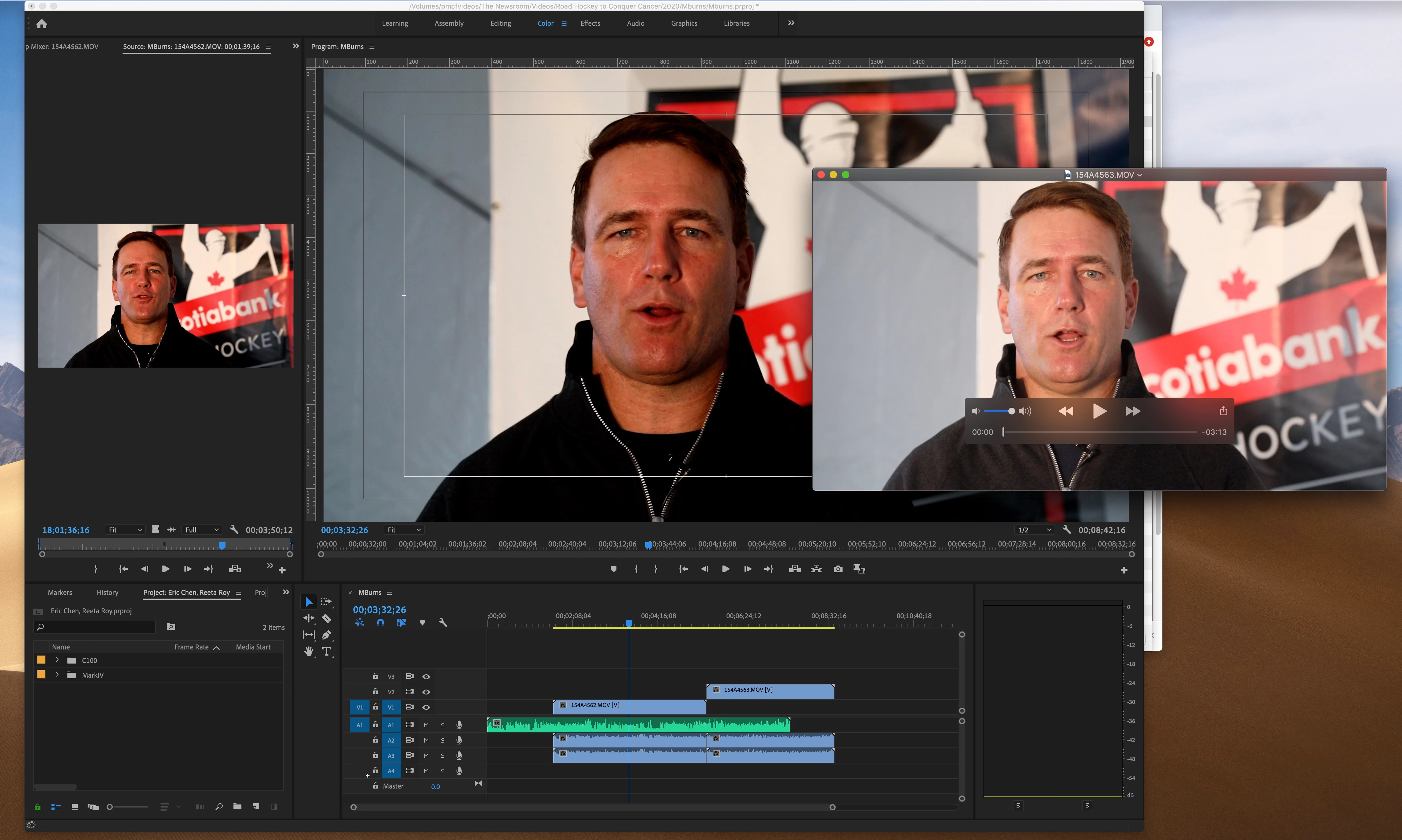

When I view my video on QT it's fine. When I pull the video into Premier Pro it's oversaturated and the colours are off. This was shot on the Canon 5D MarkIV. How can I fix this?

    to me, on my laptop junky computer, your QT looks washed out and your PPro looks too dark.
    I don't see this as a color saturation issue, but rather a basic luminance issue ( your Y values for lift gamma gain).
    Shoot a color chart with your camera with proper lighting ( color balance of light matches white balance setting in camera ) and use that to adjust what you have to do to make stuff as close to the real values as you can. You should be fine for more than 50% of work done by CC users.
    You'll have to export your test with color chart ( I would just do mp4 h264 ) and look at it using whatever viewers you use ( vlc is pretty good ).
    Most editors and colorists use mac and avid and resolve.  You should be fine after you do your test with color chart.

    The unfortunate aspect here is you're on a Mac with the Mac ColorSync utility working in a different color space and completely off gamma setting from the rest of the world. I'm not making pejorative statements, but color management for pro broadcast has for many years been video sRGB/Rec.709/gamma 2.4. On monitors set for white points of D65 and brightness of 100 IRE now "nits".
    Your monitor is a Mac "retina" it seems, with a P3 color primary space rather than the video sRGB. It is a larger color space, with especially more area in Red and Green. Neither your OS nor its Colorsync utility properly remap video sRGB signals to their proper location in the monitor, so both the saturation and actual hue values are well off from what they would be in a proper broadcast monitor.
    Next, the "gamma" for the Mac Display P3 color space (a very unique Mac-only "space") is supposedly "sRGB". However the sRGB and Rec.709 standards for gamma include both a scene-referred transform function and a display-referred transform function.
    Your monitor and the ColorSync utility only apply the first half ... the camera referred transform function. Which changes the gamma ... the relationships especially between shadows and the rest of the image ... quite notably ... from what it would be seen on any proper broadcast monitor.
    That's how you got where you are with that image.
    Now ... there is an option in the Preferences tab to "Enable Display Color Management" ... here:
    This will tell Premere to look at the ICC profile set in the OS for the monitor, and attempt to remap the image within Premiere's monitors so that it is closely comparable with how it would appear on a proper broadcast reference monitor. For working on Macs, that option should always be selected.
    This will help you work closer to actual outside standards.
    However ... once you export that file and open in almost any other app in the Mac sphere, such as QuickTime, it will still have troubles, as caused by the OS and the ColorSync utility.

    I can add this ... no pro colorist I have ever heard of uses a Retina screen, beautiful as they are, for any color correction work. Many colorists are Mac users, but no one ... no one ... grades on a Retina screen for professional broadcast use. In fact, a constant issue of discussion among colorists is how to handle their clients who view the work on their Retinas and say "It don't look right ... " ... when what ain't right is the Retina view of the media.
    So do your color correction for web work with that monitor using the "Enable Display Color Management" option. Understand it won't look "correct" outside of Premiere on that monitor. But that file viewed on most any other screen out there will appear "correct".
