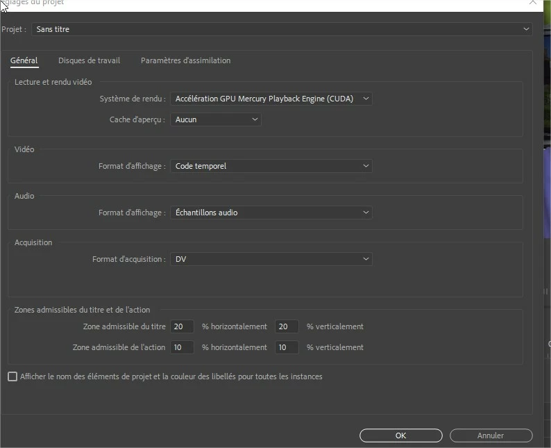

cuda.jpgcuda2.jpgSans titre 3.jpgHello,
I installed a NVIDIAQuadro P2000 card
The rendering system is of course Accelerated GPU Mercury Playback Engine (CUDA)
But this one is not taken into account when I read a file.
I tested several drivers of the card without success.
Thank you for your help.

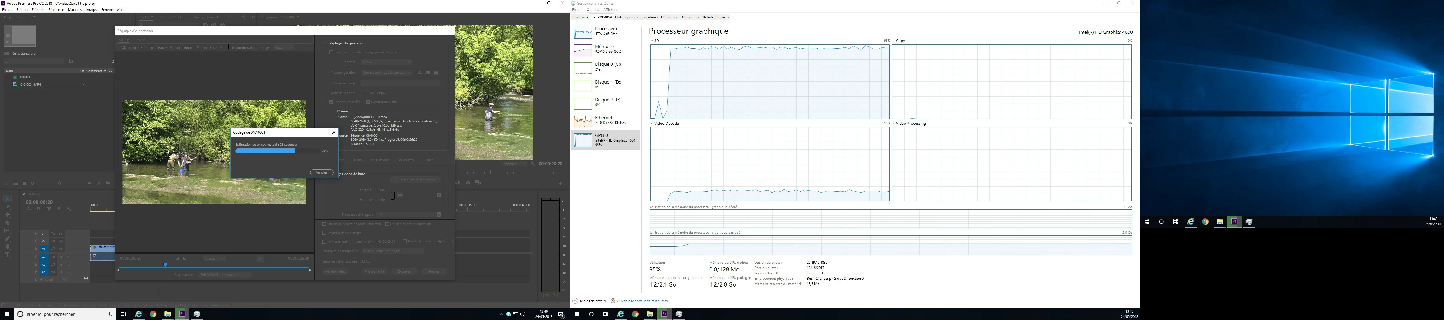

Community-Einsteiger ,
May 15, 2018 May 15, 2018
I agree with you
except that in my case it's not a performance problem
but a problem that the card is completely inactive
see screenshot of performances when I play a video
although it is checked "cuda" in the setting of the project
so between everything and nothing there is a margin all the same

LEGENDE ,
That graphic is not an accurate representation of when the card is being used in PP.  You can't use it as a reference.

Beitragender ,
May 16, 2018 May 16, 2018
Jim, that graphic is W10 Task manager and it is exactly an accurate representation of how the card is being used.
You can check it out yourself. It bumps up when rendering cuda accelerated effects.

LEGENDE ,
it is exactly an accurate representation of how the card is being used.  You can check it out yourself.
I have.  It's just not a good way to verify CUDA.
