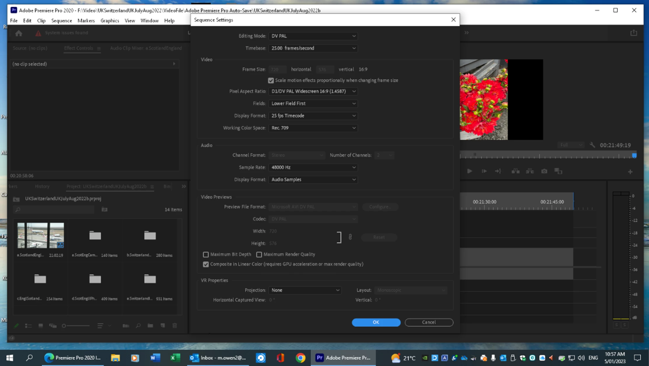

Many thanks for your advice. I will attach the Sequence Settings for the video file created as advised. I'm wondering if I'm trying to do the 'impossible' by combining still and video images from both the IPhone and Nikon camera on the one Timeline? To put the video file on the Timeline I think I need the 16:9 ratio and not 4:3 that appears to be the default setting.

First, with your problem project loaded, send us a screenshot, of 'Sequence Settings" from the Sequence menu up top.

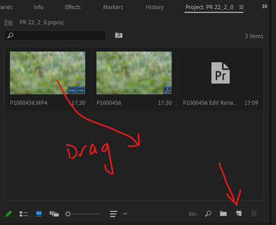

Then: Start a brand new project. Import you image, drop it on an empty timeline.

Hi MyerPJ,
I will attach two images, MalcolmPremProImage1 and MalcolmPremProImage2 with the second after starting a new project. The image in the new project appears to have all the image now on the Timeline.

Yes, thanks. So, the original timeline / sequence is DV size 720h 576v (1.4587), and pixel size is not square.
Your sequence setting in the original is not correct. What are you trying to do? HD, 1920x1080, typical type thing?
So, I suggest you create a new sequence 1920x1080, and then select all the clips in the bad timeline and copy them in the new one. If that is workable, great. You'll definitly need to work on the clips "size" when you do that. Otherwise, if you've just started. Create a HD sequence and start again.
