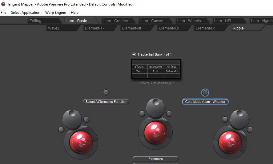

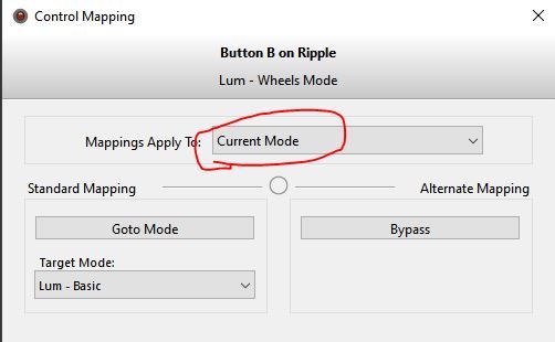

January 29, 2024
So there are no bugs in Tangent ripple? I think of buying it again - I regret having sold it years ago..
TangentWave
February 1, 2024
Check in with Tangent ... Andy and Chris both have been pretty awesome at responding to questions, and helping to figure stuff out. With the one proviso ... you know about engineer mental approach, right?   😉
So at times we need to be quite specific about what we don't understand and about where we want to 'be' ... and again, they are very helpful. They're across the pond to jolly old England ... so sometimes it is the next day before the email comes back. But I have enjoyed working with them on several projects.
