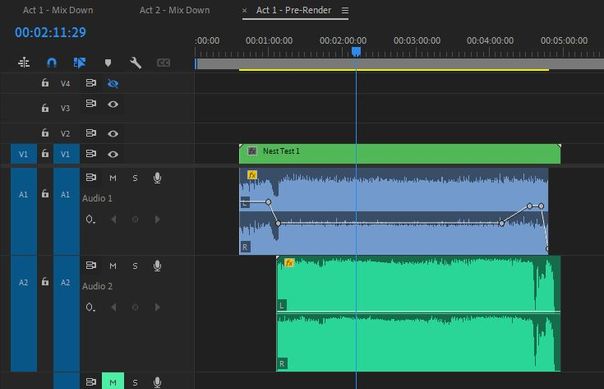

Community Beginner ,
May 01, 2022 May 01, 2022
Just to be very clear.  No this is not sorted in the latest release.  I am using Premiere Pro 2022 (Version 22.3.1)
I have a sequence which consists of a series of dance performances.  The video is shots edited from three cameras.  There are two audio tracks, the on camera audio from one of the cameras and the music track.  I want to nest them so that I can then top and tail and transition into each performace more easily.
To nest I select the video and audio tracks then right click and select "Nest":
As the Original poster on this post and others in teh replies have pointed out, the video clips nest into a single Green Nested clip, but the audio tracks stay as they originally were:
If you open up the Nested sequence you just created by its self, you can see that it contains all the video clips AND the audio clips as expected:
So the problem is that a nested audio track is not being created and displayed on the original sequence, even though the nested sequence its self does contain the audio files as it should.  And the problem is not that this is a bug from an old 2018/2019 update since this is the latest 2022 update.
Now for the love of god can someone at Adobe please acknowledge that nested sequences are not displaying correctly and let us know what we need to do to get them to work.
Thanks so much,
Tala
LEGEND ,
I looked through your images, and in the third (nested) image, what are you wanting to see different? Collapsed to one audio track, what?
As what shows in your image is the video with both audio tracks ... which would allow adjusting them separately if wanted/needed.
I'm guessing you want the audio tracks collapsed into one?
Neil

May 02, 2022 May 02, 2022
Tala,
I just tested 22.3.1 and Beta 22.5.0.15. I have not tested for this previously.
I confirm there is a bug.
I created a sequence with a two video/audio clips. (I get the same results if I use a second independent audio track.) If I select all the tracks, right click, and "nest," I get a nested sequence with one video track and two audio tracks. If I double click on the video track, it opens the original, unnested sequence (with the new name). If I double click either audio track, each opens as audio only in the Source Monitor. I would describe this as the video is nested; the audio is not.
The state of the "nest or individual clips" button in the timeline options does not change the problem behavior. Nesting works as expected if creating the nest with the source sequence in the source monitor. It also nests correctly if I drag the original sequence from the Project Panel to the "new" icon.

Adobe Employee ,
May 10, 2022 May 10, 2022
"Now for the love of god can someone at Adobe please acknowledge that nested sequences are not displaying correctly and let us know what we need to do to get them to work."
Ok, this is someone from Adobe.  This is not a bug, this is working as it should.  When creating a nest, and audio clips are across 2 or more tracks, the audio portions will not be nested, this is how Premiere has worked forever.  If you have video and linked audio clips, and the audio is across two tracks (on separate tracks) the nest will only work for the Video clips, and the audio will remain untouched.
If you try to nest audio only, with no video, across two or more tracks, the nest option will be greyed because there is no work to do.  Nesting audio only on a single track does work.
Very plainly, Premiere cannot nest audio across tracks.
Now, there is the reason why.  The complexity of Premeire's audio tracks system makes this impossible in a lot of cases.  Premiere can have track audio effects, tracks Sends, and track outputs that would be impossible to recreate with a nest.  So, in some of those cases, the audio would sound drastically different if the audio was nested and any of those items were discarded.  Example: a track effect that is only on one of the two tracks that need to be nested.   If the audio was forced into a nest you would have a potential doubling of the track effects, which is not ideal (and would sound very different).  If the track has a send, you can't recreate that send to bypass the Mix/Master track (and the send would not function in the nest).  This is just two examples of many that make this impossible.  Premiere will not allow you to nest audio and have that nest sound different than the original un-nested audio.
