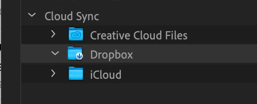

Premiere Pro's media browser does not open Dropbox folders. Can't link files in the dropbox folder.
Explorer ,
Nov 23, 2023 Nov 23, 2023
Premiere Pro's media browser does not open Dropbox folders. Can't link files in the Dropbox folder. Is there are way to fix that?

I never had problems with Premiere Pro and Dropbox before. Never lost anything. Even if the files were online, when Premiere accessed these files, Dropbox downloaded them and everything was fine. Now the problem is that after the last update, Premiere Pro's media browser does not see the content of the Dropbox root folder.

I have Mac Os Sorona and I just upgrade my Pr Premier Pro  to 2025. I went to Pr Pro Settings  and click the Dropbox button. Thats allScreenshot 2024-11-25 at 9.29.02 AM.pngScreenshot 2024-11-25 at 9.31.50 AM.png
