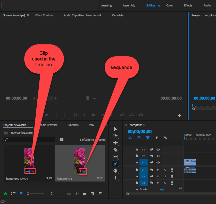

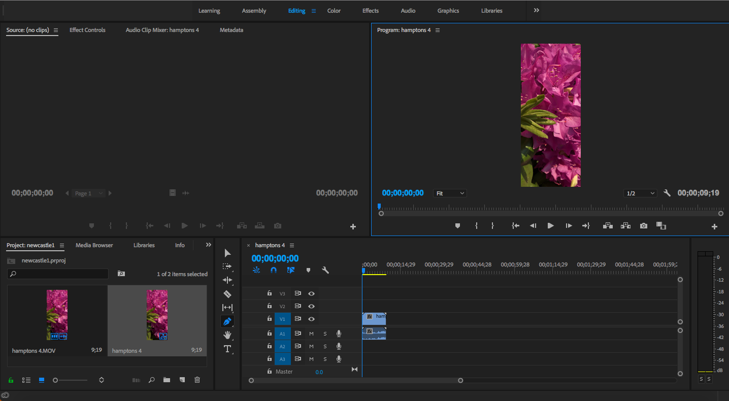

The clip on the left of the media bin is the clip I dragged from my files. It then gets duplicated to the right of the original with a different icon in the bottom right hand corner of the clip. I am not sure what this is, but it is interfering with me being able to edit the footage properly.
Sep 21, 2018 Sep 21, 2018
That (Hamptons 4) is a "sequence," and what you see in the bottom right is the "sequence" icon. You get that when you drag your clip (Hamptons 4.mov) to the "new icon" and it assigns that clip's name (without the .mov extension) to the sequence.
You can add more clips to the timeline and they will be part of that sequence.

Thank you! I am wondering though why it is creating that sequence because that did not use to always happen. Because when I got to resize of rotate that clip the dimensions are messed up and I can't edit the footage how I would like to.
It has always been there.
If you want landscape set up a custom sequence.
