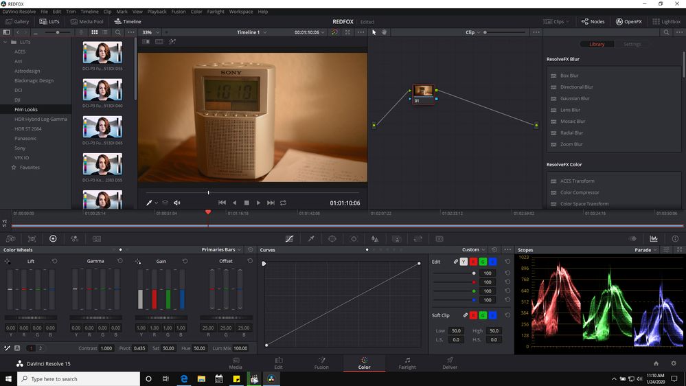

In Resolve 15 there's a panel of LUT 'gallery' stuff you can open. This sample is from laptop (not much real estate for real editing via small screen).
you put mouse over thumbnails of LUTs or LOOKS and can scrub through the thumbnail to see effect on program monitor. However, you have to deal with cleaning the node if you happen to 'apply' that LUT to get back to your original.

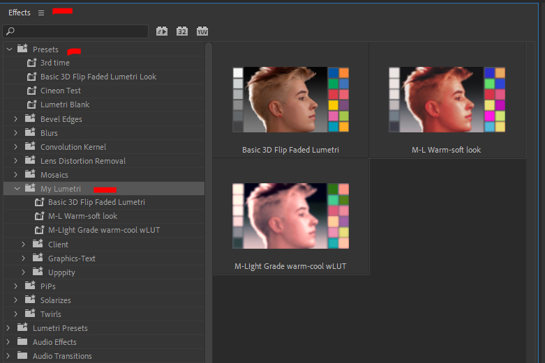

Use the Preset panel. Apply each LUT or Look with no other corrections, then save as a Lumetri preset ... they'll show in the Effects Presets bins as you choose. Here ... this is a sample. And yea, they always include that dude's head and the greyscale and color chart.
You can then get an idea what they do ... and either drag/drop that directly onto a clip or select the same named LUT/Look from the Lumetri controls.
Neil

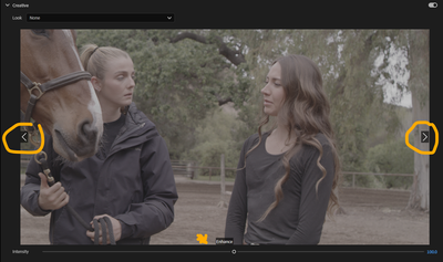

One more thing, to preview them, just select one in the dropdown list and in the preview window withn the Lumetri pannel just push the right or left arrows in this window.

You can only preview one at a time using this method? Is there a way to preview the LUTs with your clip?
LEGEND ,
Feb 19, 2022 Feb 19, 2022
The preview window in the Creative tab shows your clip with the LUT applied. You can use the left-right arrows on the screen to go back-forth through the LUTs the Creative tab can see if you've got your LUT folder properly set up.
Or you can use the drop-down list to select the LUT, and it will preview in the Preview window.

Yes - this is the correct advice and works great with the arrows option. However, for those who use 'adjustment layers' to color clips rather than coloring the clips directly, the preview LUT option does NOT work if you're trying to preview options in the 'adjustment layer'. You must preview options with the actual clip selected.
