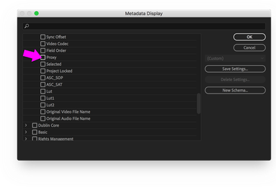

I think this was mentioned earlier, but here's a screen shot.  Enabling Proxy Status in the Metadata Display of the Project tab can be very helpful.

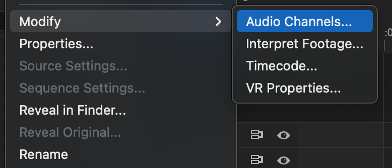

One other thing to know. Often you will have empty or "dead" audio channels, because there are 4 audio channels possiable for a camera like this. If you only recorded on 1 or 2. Right click on the file in your project window go to Modify, Audio channelsScreen Shot 2022-10-26 at 9.38.53 AM.png
Then de-select the channels that have no audio on it. This will save you a lot of work later when inserting them onto the timeline.
