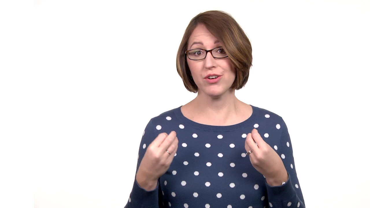

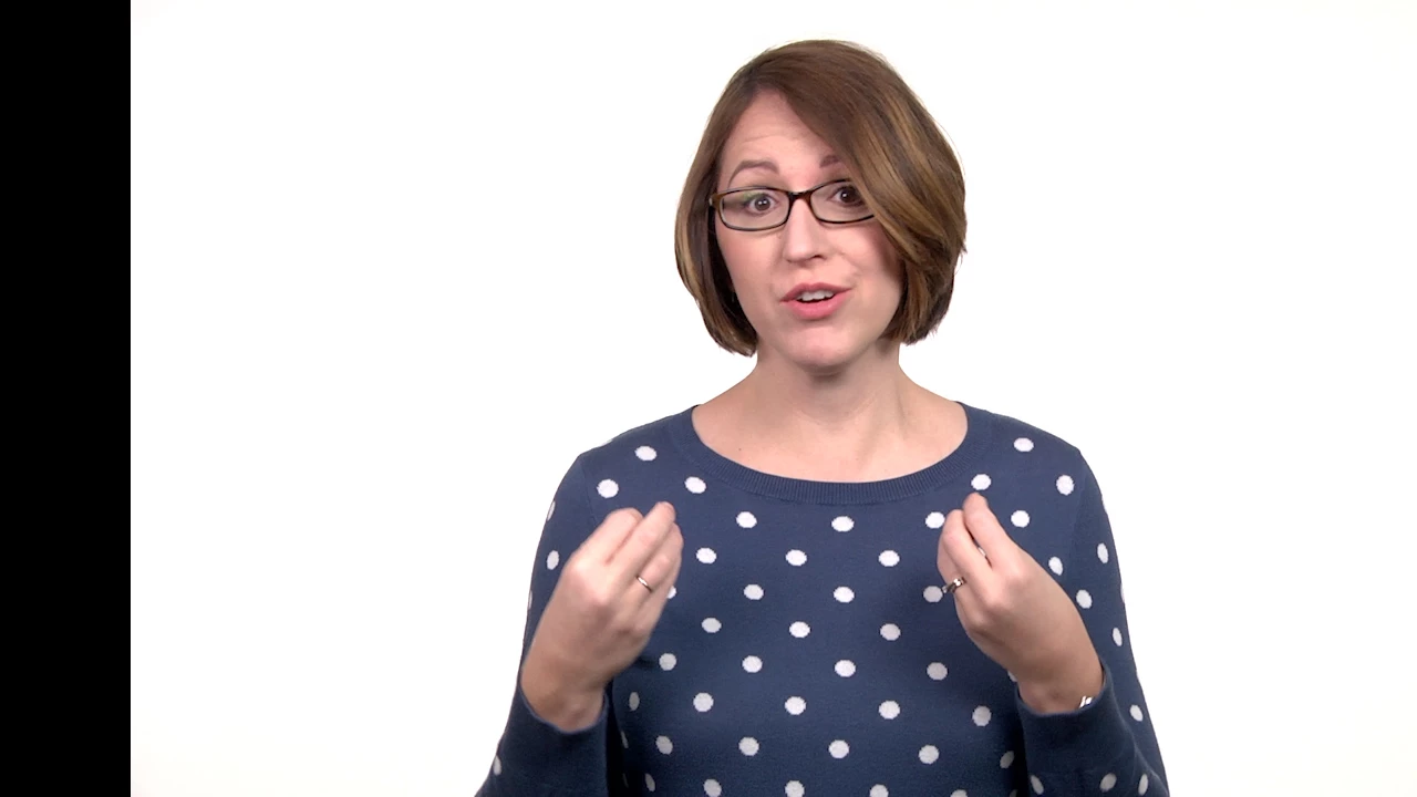

Okay, I've been doing a little more testing on my own and, while I still haven't come up with a solution, I have figured out an interesting bit of info.  This "invisible track" behavior seems to be somehow tied to the amount (percentage of the frame) of the V1 track that is showing through in the background.  See the screenshots below (I've changed the background matte to gray to make it easier to understand where the edges of the foreground clip frame are):
These two frames are the exact same clip (same scale - 100% - no other effects), but the first one is moved over to reveal more of the background (V1 track).  This clip displays correctly (gray matte showing) after reopening.  The second clip, where less of the V1 track is revealed behind the foreground clip, behaves the same as before (gray matte disappears).
A second example.  Again, exact same clips and same scale (but smaller scale than the above example).
There seems to be something about the position of the top clip, and the amount of the bottom clip showing through, that is determining whether this issue presents itself or not.  I'm really not sure what to make of this information, but I thought by sharing it here maybe it would spark some thoughts in someone smarter than me.  Again, this does not seem like a very unusual or complex editing technique I'm using here, and I'm really hoping there's something simple I've been missing all along.  Help?
