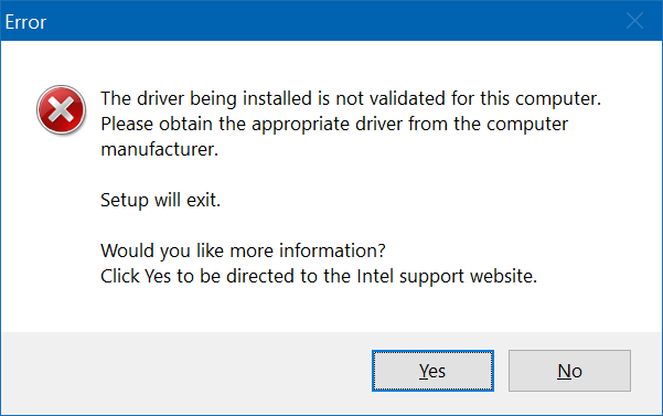

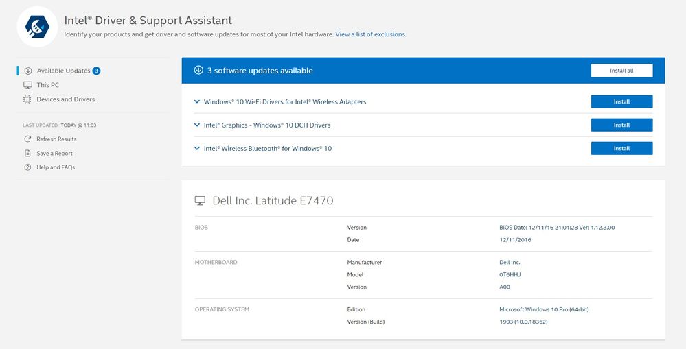

Thanks for the help. The links you provided me led me to install the Intel® Driver & Support Assistant which autmatically helps me install the latest software updates for my pc. I got 3 available updates in which one showed the following driver: Intel® Graphics - Windows® 10 DCH Drivers.
 I downloaded and installed this driver and got the following error:
It says that my computer has available driver updates, but when I download it it says that "the driver installed is not validated for this computer." I don't know how this works. And *why* it shows me an available update if its not validated for my computer.
A.KodirovAuthor
July 14, 2020
Here is the problem:
Your PC was manufactured and sold prior to Intel's adoption of the DCH driver model for graphics drivers. As such, it uses an OEM-customized version of the legacy Intel drivers. Unfortunately, these OEM-specific legacy graphics drivers very seldom get updated at all by the system OEM. And those that do all too often only update the drivers once or twice, and then completely discontinue all support whatsoever for the model(s) in question.
Worse, Intel's generic graphics drivers cannot be installed at all on top of any OEM-specific legacy driver no matter what. So, the only way to properly install the new driver would be to temporarily disconnect from the Internet, completely uninstall and delete all traces of the OEM-specific graphics driver, and then install the new driver (all while temporarily disconnected from the Internet). Restart your PC. At this point you may now reconnect to the Internet. If you do not disconnect from the Internet during the update process, Microsoft Update will re-download and re-install the same old driver version that's giving you compatibility trouble on top of the new driver - which is what you don't want at all.
