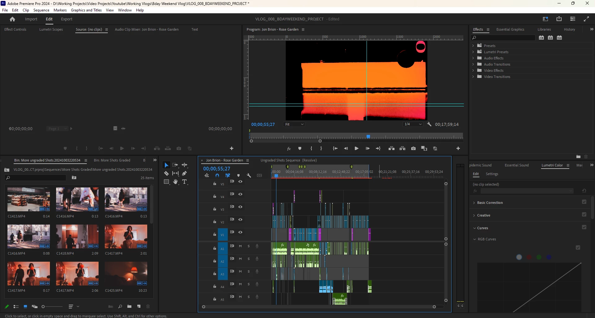

Hello Everyone,
So I'm making a video with quite a bit of effects. Intertitles, overlays, mixed media essential graphics, clips with fade ins and outs, the works. However, I find Davinci's color grading to be far superior to Premiere's in quality and efficiency, so I exported the timeline as an xml, brought it into davinci, graded them, and am now trying to bring the graded footage back into the premiere pro timeline to replace the ungraded footage. However, as you can see from the provided screenshot, there were quite a bit of assets and particular SFX and VFX aligned with particular clips. I'm wondering, is there any way I can insert that graded footage right where the ungraded clips are? With the fades, effects, and adjustments made direclty on the clips preserved? Thank you in advance!

you can always try to give the graded clips a prefix or suffix, place them in a folder, offline all your files that are on the sequence and then try to link the graded files.

The full round-trip process is a bit of a pain but there are some major parts to it.
First, do you have new media from Resolve for all that, or only the video clips?
For video clips that you have replacements for, the replacements must be named identically to the clip they replace, should be in similar folder structures. You "offline" the old clips in their bins in the project, then relocate using the new clips.
You should only need to locate one clip per folder/bin, PrPro should auto-select the rest.
This proces replaces the clips on their current sequence, and should not affect transitions and such.
