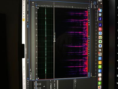

 Howdy,
I've been googling a lot on audio for the Wireless Pro/Wireless Go 2 systems. I have both, but since upgrading to the Wireless Pro set I can't seem to get the audio levels correct for my video content. It seems that no matter the settings of the mic/camera when I export the audio and drag it onto my timelines, it is extremely low. I have to amplify it by +20 or so for it to be usable... I have ran tests but no matter what it ends up the same once I drag it onto the timeline in PP or Audition. Luckily the quality of the mic is still pretty good and the audio is still usable after I do a little noise reduction to clean it up. But it's still a pain, because inceasing the gain that much obviously increases the noise floor and creates noticeable unwanted hiss. Not enjoying this workflow and wondering why in the world it's importing so low. 😑
Anybody else experiencing this?

How are you recording that? If you do have the levels set correctly, they should come into Audition or Premiere fine.

The mic is set to standard (-12) my camera is at standard (-9).
And I use the 32 bit float. The audio is low on the camera and on the separate mic recording. So I'm kinda puzzled.

If you didn't use 32 bit float, what do you get?
I'll bet that's where the "anomoly" comes in.

It seems like you're recording at way too low levels. The Rode Wireless GO II Pros allow for 32 bit float recording. This basically means you almost cannot record beyond clipping levels. If you set this device then to -12dB, you are effectively capping it off at the knee. Set the mic to 0dB and see how it then comes out.
I have my Rode Wireless Go IIs (not the Pro versions) set to 0dB or -3dB and the audio comes out just fine.
