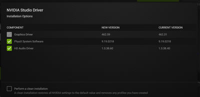

I noticed the HD audio driver was also updated, screen shot below for the records.

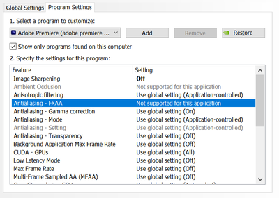

Thomas; Thanks for the tip; I went in to apply the correction noted in your link and posted into the message. The current state was already off (screen shot below). I cannot say if that settings default value changed with the driver, I just applied, as I applied the driver update before I looked at this setting.
I can say that even in its off state, the tearing was there. It was not until the vhold setting (noted by scrozier) was applied that the tearing resolved. I'm still not convinced it's as good as it was before, but the tearing was not even bearable, so this is an improvement.
Thank you for the great advice, and direction none the less. You tip may be applied as the default setting on the 462.59 05/11/2021 driver. Maybe someone with an older version can check the setting before they update if we as a group feel its important to have that documented.

Thank you for verifying. Yes, the Antialiasing-FXAA and Image Sharpening are default off for quite some time. That said, some pro users might make changes for experiement, or accidentlly made the changes in the global config page when turning them on for other games/apps, which then unexpectedly turned them on for PPro.
I am glad to hear that forcing enabling VSync resolves the issue for you. We currently have VSync disabled by default as it has some pros and cons. What's your monitor refresh rate by the way?
