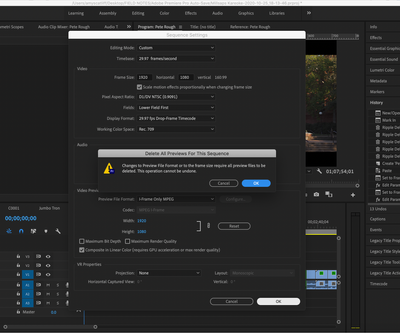

I'm trying to export a timeline sequence to an mp4. When I did export it--the timeline completely jumbled-whole sections of images were missing, clips I did not include in the edit appeared, etc. It was so strange...I have no idea why...
This is what the timeline looked like. So I went back to an earlier autosave and created a new sequence to export as an mp4 to a high-quality HD setting.
I wanted the image to fill the screen at 100% but it was set to the following below. When I try to reset it for 1920x1080--I get the following message. I'm afraid to select anything. Is it ok to follow-through? Thanks.

Any time you change anything about a sequence, any previews will be no longer useful, so it dumps them. No problem at all, they're just previews.
Curious about the non-square pixels ... any reason for the .9091 PAR setting? What's the media?
And what's going on in the area with diagonal stripes on clips?
Neil

To start with, take a look at the properties for the footage and make sure that it matches the sequence settings.
This is what has gone wrong from start, you have editied on a DV 720x480, interlaced, Lower Field First timeline and probably placed 1920x1080 footage on it and use the Position/Scale to "move" the footage to the intended place in the video frame. Then you have changed the sequence settings to 1920x1080 but still keeps all other settings, iow Pixel Aspect Ratio to DV NTSC (0.9091), Lower Field First while it should have a Pixel Aspect Ratio of 1.0 and either Progressive or Upper Field First. This results in sections of video missing in export.
Thumb of rule:
If the footage is 1920x1080, 29.97, Upper Field First, the Sequence Settings should be 1920x1080, 29.97, Upper Field First and the export should be 1920x1080, 29.97, Upper Field First or 1920x1080, 29.97, Progressive if it is intended for the web.
When using footage X on a timeline with Y setting and export with a X or Z setting you will have problems and the export will look bad. Avoid any mis-match.
So make sure to know your source footage, right click on it and choose Properties. (See image below) Make sure that the Sequence Settings match the settings of the source footage. Then you have to manually reset the properties for the clips on the timeline that you have adjusted Prosition and Scale to get back on track.
Short version:
The issue is not the setting you use when exporting, the issue is the settings and workflow you used when you started the project. 🙂

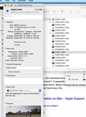

Thanks for your reply. I filmed 4k with a SonyA7iii. When I click on "get info" on my Mac on the clip I get the following image (see screenshot above). Does this show all that I need to see? Still learning how to film and understand the terms correctly...
For the timeline sequence, I was importing the 4k clips to a 1920X1080 setting and then resizing the clips from 50% on up on the timeline because I was exporting to HD High Quality and thought it was still ok to do that up to 100%. I think that's what you are saying perhaps messed things up--plus not having the correct settings on the timeline sequence settings when I imported the files to start with.
As you can see I have some really wonky settings for my timeline sequence here. So for the 4K footage exporting to 1920x1080 do I need to follow the settings you mentioned here?
"If the footage is 1920x1080, 29.97, Upper Field First, the Sequence Settings should be 1920x1080, 29.97, Upper Field First and the export should be 1920x1080, 29.97, Upper Field First or 1920x1080, 29.97, Progressive if it is intended for the web." Thank you!

Ok-so I'm right-clicking on clips inside the Project Bin in Premiere and I see Properties vs. Get Info and it says more of what you are talking about... I'm surprised the framerate was 23.. I thought I set it at 29...
You had a DV setting in the timeline you posted in the first post, that´s the same resolution as a DVD and very far away from 4K. That will cause problems.
Using 4K footage on a 1080p timeline is not "wrong" and can have advantages if you want to reframe the footage for some reason. But it is more convinient, IMHO, and timesaving to edit 4K in a 4K timeline and upon export just export to 1080 and be done. That requires no fiddling with Scale or Set to Frame Size when editing. It is a godsend to edit 4K in a 4K timeline the day you want to export it as 4K. Both ways has it´s advantages and dis-advantages.
I have indeed done the same mistakes as well back in the day and what i learned was to always know my source footage (resolution/framerate/pixel aspect ratio) to save time and have the sequence settings match the footage.

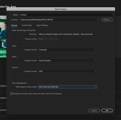

Hi
Looking for the right settings to create a 4K timeline. I shoot 4K with a Sony A7iii with plans to export HD. Any suggestions? Again, thank you!
 Screen Shot 2020-11-01 at 5.20.15 PM.pngScreen Shot 2020-11-01 at 5.22.50 PM.pngScreen Shot 2020-11-01 at 5.23.19 PM.png
Nov 01, 2020 Nov 01, 2020
The easiest way is to right click on a source clip in the Project panel and choose New Sequence From Clip. Then i would go to Seqeunce > Sequence Setting to double check that everything is correct.
