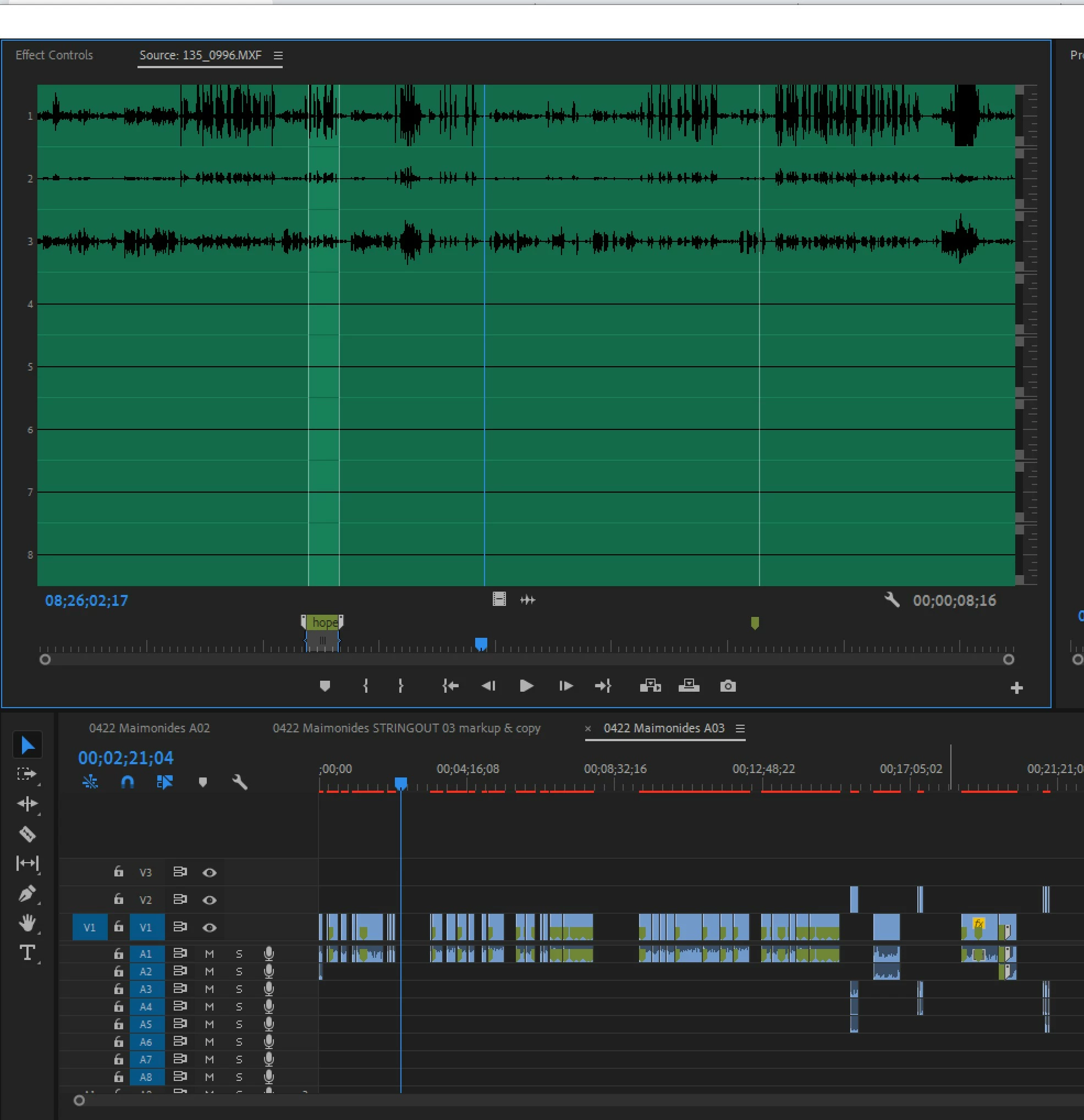

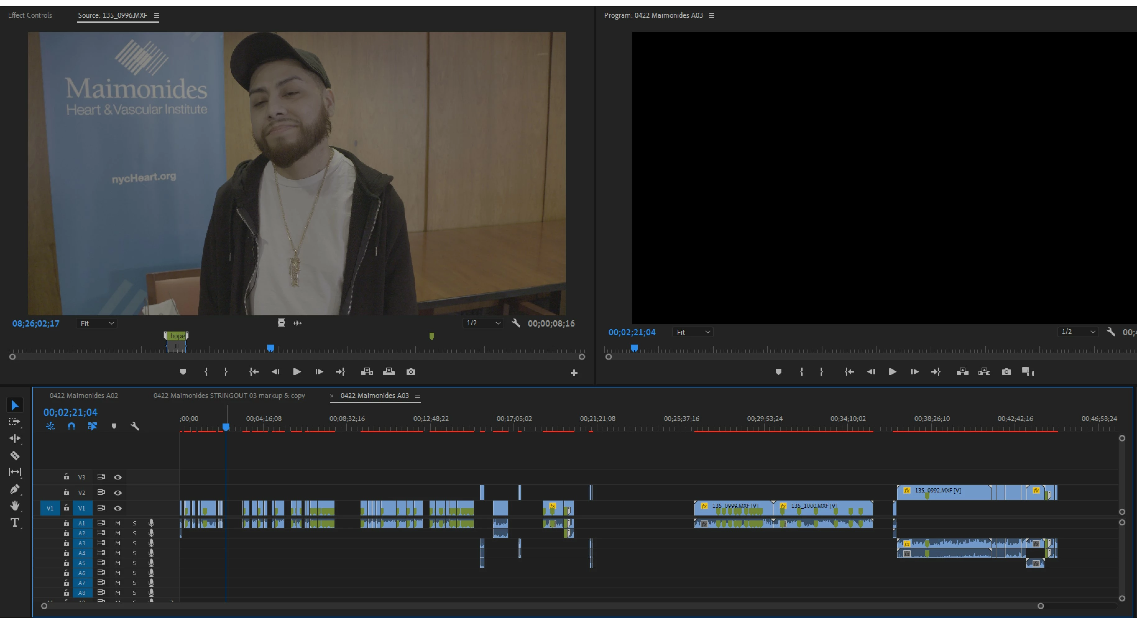

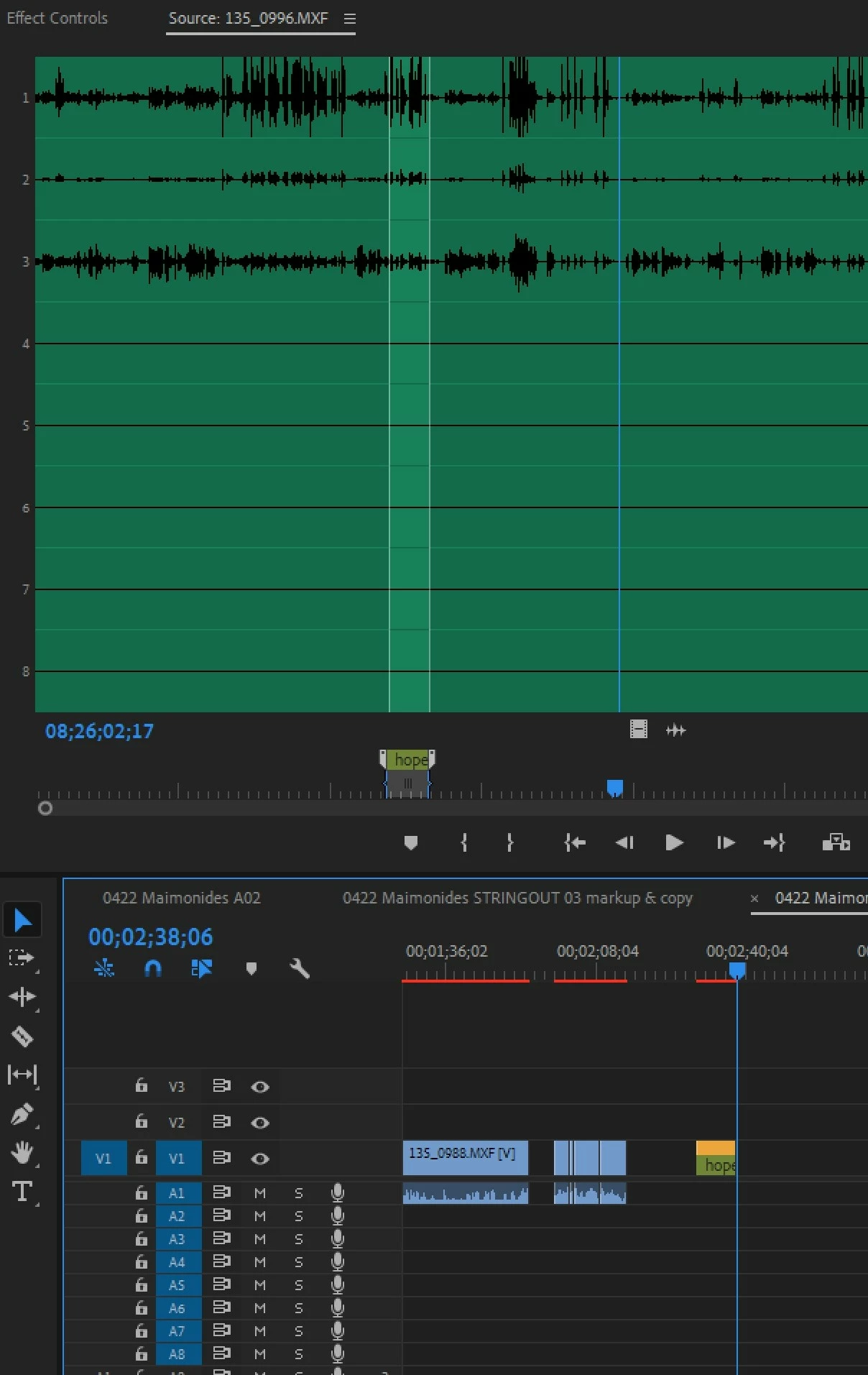

Premiere Pro is not letting me select any tracks for source patching audio. With Source selected, only video track comes up in Source patch bay.
When I click on the Source patch buttons nothing happens. A few times, when I would insert the clip, a track would be *automatically added* to the existing tracks and the audio clip would appear there. If I alt-selected the track and tried to move it up to the next track, it wouldn't budge. The source patch button for the new track with the audio would be selected, but I wouldn't be able to select another track in the source patch bay. But that stopped happening. Now when I insert the track, the audio simply doesn't appear.
The behavior is as if the tracks were locked, but they aren't. I can lock and unlock the tracks with the lock button. The clips have 8 tracks of video. I closed the project, reset the preferences, cleared the media cache. I created a new sequence and copied the clips into it. Bug persists.

So ... you don't have a "Source" track target set in your image for Audio, only the one for V1 video track.
Is it not letting you set an audio source target block?

Per the above, when I click on the audio source buttons, nothing happens. When I click on the source, just one audio source track button turns blue...sometimes.

The workaround I have now is that I had strung out all the footage in a previous sequence. I can copy and paste into the current working sequence. I haven't noticed any problems with the Target bay.

I haven't been using all those tracks, I was just inserting a clip with 2 or three tracks when the Source patch bay was working.**Interestingly, now, with a clip with 8 tracks in the Source window, only one Source track shows blue in the timeline, and it, again, appears *after* the last track, a new Track 9.

Does the video coming from the source monitor have the same amount of audio tracks as the footage that you created the timeline with?
April 28, 2021
The previous sequences that had the problem were copied from one with 8 audio tracks, which is the most tracks that I have in footage. Then the new one which still has the problem was newly created; it has 8 tracks. The footage has 8 tracks.
