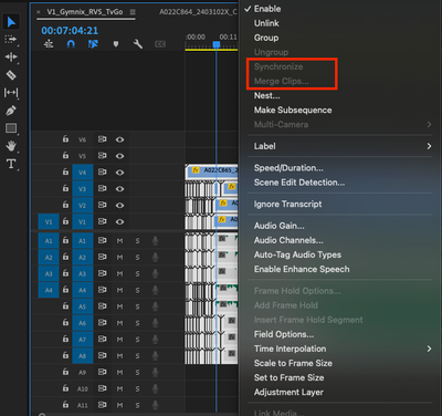

This is August 2023 Update, I am going thru the same situation where the "synchronize" option is greyed out and unavailable. I have tried ALL of the options mentioned in this thread but regrettably none have worked.
My situation: I Have three Cameras with audio (6tracks) plus three external audios (Lavaliers) for an interview that I'm trying to sync up to do a multi-Camera edit. but the sync option is greyed out despite tryting all the options I saw in this clip. Does anybody have an alternate solution they can share??? I tried:
1. The targeting tracks option did not work
2. the Turning of Linked selection did not work.
3. The render timeline option also did not work
Here's ma screenshot of the timeline. Thank you all in advance.

August 18, 2023
Yes. You won't be able to select multiple clips with different audio on the same track and synch them to clips on other tracks. Each segment will need to be synchronized individually and then pulled back together.
My suggestion, and this is going to sound tedious but it's not too bad.
1.Separate your clips horizontally (on their tracks) by at least one clip length, large empty gaps. This leaves room for PP to move tracks into synch.
2. Think about each short clips like a scene and cut the longer clips up so that you can synch one recorded section at a time.
ie. isolate all of the audio for clip 1 and sych those, for clip 2 and then synch those.
As you're cutting up your longer recordings to match the shorter clips,, you can drag the ends out so there's over lap.
Once each clip's audio is synched up, you can drag the ends back in to remove overlap and then close the gaps to pull your sequence back together.

I just have two cams and two audio tracks to deal with and sync is greyed out. Ive tried the targeting but I couldnt for some reason get the V1 and A1 to be showing on the left of the padlock?? Ive just looked now and  the blue boxes have suddenly appeared there for the first time today. No idea what I did but again; sync is still greyed out. Tried separating everything onto sepearate tracks also, no luck.
