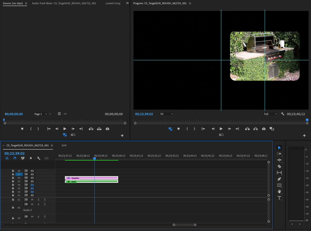

I created a shape/graphic and centered it. I nested my clip, then applied the track matte key to my clip with the shape/graphic layer as the matte. When the matte is applied, the image moves up and is no longer centered. How do I keep matte centered?
Screenshot 2023-07-06 at 11.02.20 AM.pngCS_TargetGrill_ROUGH_062723_001.00_00_58_17.Still002.pngCS_TargetGrill_ROUGH_062723_001.00_00_58_17.Still003.png
You can see the shape/graphic layer outline and the video above it here:

The image is meant to be centered on the right 50% of the screen. My issue was the shape/graphic was the postion upward even with the clip nested and then track/matte/key applied.

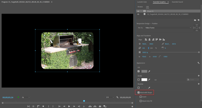

How do you mask a video clip with a essential graphic/Shape layer?

Using the Graphics workspace, put a shape from the EGP Edit tab on the track above, position, and use "mask with shape".

Of course it will work with a video clip too.

I should work. See screenshot 23.5

Jul 09, 2023 Jul 09, 2023
quote
By @edit58989569
Just study the screenshot I posted.
LEGEND ,
As Ann's pic shows, and I mis-wrote ... sorry! ... you can use the clip in the graphic then mask with shape above the clip in the EGP layer stack.
Exactly as Ann's pic shows.

Ahhh I see. How do you get the clip in the essential graphics panel?
LEGEND ,
At the lower right of the Layers part of the EGP is the "new item" icon.
From that you select text, shape, or importing images which can also be video clips.
... or drag from the project panel.
