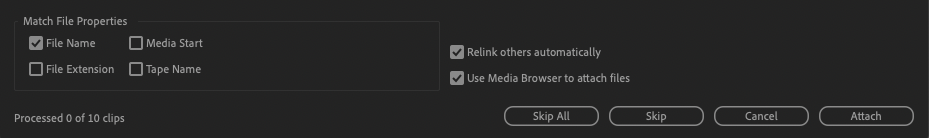

I'm importing 4K Sony A7SIII footage into Premiere 22.2 (and previous 22 versions). I'm able to import the 4K files, but then when I attach proxies I've made in Media Encoder (as I've done for a year now in Premiere/Encoder 2021), the proxies only attach one by one. I have to go file by file to attach proxies, which is just not an option with the number of files I'm working with.
Does anyone else have a similar issue and/or a workaround for attaching proxies quickly to 4K files?
I believe I've figured out the issue with auto-linking the proxies, which is that the in the latest version of Premiere (22.2) the 'Match File Properties' for linking seemed to be causing the trip up. The default is for all the properties for linking to be checked (at least that was my experience). I believe the issue is that the 'file extension' box was checked, and the proxy files I'm working with are not the same file extension as my original 4K files. I unchecked several of the boxes (see im

I believe I've figured out the issue with auto-linking the proxies, which is that the in the latest version of Premiere (22.2) the 'Match File Properties' for linking seemed to be causing the trip up. The default is for all the properties for linking to be checked (at least that was my experience). I believe the issue is that the 'file extension' box was checked, and the proxy files I'm working with are not the same file extension as my original 4K files. I unchecked several of the boxes (see image below), leaving file name. The proxies have been automatically attaching consistently in my tests. I hope this helps others who update Premiere and who may have a similar issue.

My proxies also had a similar extention. The steps above meant premier read them and synced them without a problem. As long as you select them in the project window and attach them all at once then check the above boxes in the media browser when syncing Premier should do the rest. Make sure your proxies are all in one folder

For me, using c70 RAW footage and attaching MXF proxies, I finally got it to batch attach when I only checked "Media Start."

Same here, checking 'Media Start' , and unchecking the others worked as a batch.

Finally worked after i checked FILE EXT. only

Simple Solution for Mac:
I use a Sony Cam that creates proxies automatically - I was facing the same issue. I went into the SUB folder, selected all my S03 Footage and Right Click > Rename. This opens up a native batch rename funcion that does not need bridge or anything manual. Select the option "Replace Text" type in S03 and replace it with _Proxy. Only check "File Name" in Premiere and it worked flawlessly : )
