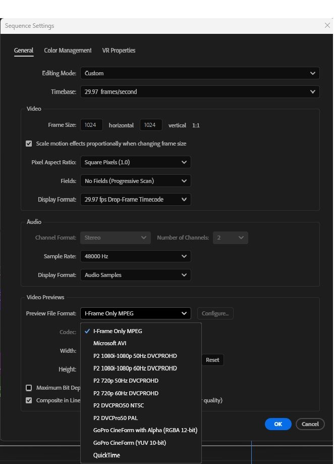

I am trying to export an video meant for a facebook ad at 1024x1024. No matter what I do, my video comes out at 4:3 with the top and bottom of the video being cropped. Here are my settings, a screenshot of the thumbnail and propertied in exlorer, and a screenshot of what it looks like in Media Player.

Set preview codec to Prores LT
Turn off hardware encoding and try cbr.

Prores lt is embedded in premiere
go into the sequence settings and change the preview codec from iframe to prores

Here is what I'm seeing. I don't have the option to select configure next to the file format. I thought maybe there would be further options there.

File format Quicktime > codec Prores

Try the modified project attached to this post.
Disabling "Video is VR" during export as @Averdahl recommends is probably enough, but I made some additional adjustments to the Sequence settings that are better suited for a custom 1024-by-1024 Sequence that uses a PNG with stock video. Namely, changing the editing mode from DSLR to Custom, changing the frame rate to match the stock video (24 fps) being used in the project, and changing the Video Preview from all I-frame MPEG to ProRes 422 (LT).Pictured: Custom Sequence settings for a 1024-by-1024 Sequence
