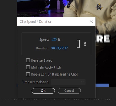

Good morning folks! I edited a quick interview in which I had to speed up in 20% to make it faster for Instagram content. The thing is that some parts of the audio came out with some "echo" or "stutter", I dont know exactly how to define that. I'll tell how I  edited that and I'll also upload a part of the interview that clearly shows the issue.  Any suggestions about how to fix that? Thanks a lot 🙂
1- at the sequence, I changed the Speed/Duration for 120% and DID NOT CLICK on "Maintain Audio Pitch", I don't like how it comes out if you change the pitch this way
 2-I applied a Pitch Shifter effect at the track and got it 4 semi-tones lower. That fixed the pitch issue, it sounds good in general, except for some very short parts in which there is this "echo/stutter". Coincidentally or not, they're located exactly where I cut some parts of the video, when the following one starts.

Try using an audio transition at the cuts.

Peru Bob's answer was a very major thing, really. It's one of the reasons that many experienced audio people do prefer to head to Audition for audio cleanup & polishing. As ... it's so easy to simply grab the edge of a 'cut' and set a transition between audio clips there. A short transition on each cut, and wow ... the difference that makes ...
Everyone's mileage always varies ...

Smooth! That solved the issue. Thanks a lot!
