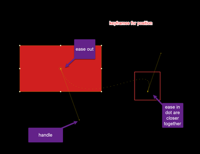

Just putting ease out/in on the scale propertie does not produce a curve. It eases out at the beginning and eases in at the end.
If you want to see a curve you need to set keyframes for position and adjust the handels or set keyframes in between.
