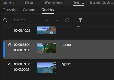

As you can see the transcription system is not doing it correctly i want to put the time manually, how can i do that? Ty

Audio 2 / A2, thats why i put the red mark. I mean the green mark is the wrong timing, the subtitle should be also inside the red mark.
How are you adding/removing?  For example, you can do an insert from the Transcription tab in the Text Panel.
The captions are already created, if there is an error with the timing how can i solve it? I cant add new subtitle in the captions panel and i cant change the timing of a single caption.
For example, if you see the image, if i wanted to change the "bueno" caption, 00:00:58:01 - 00:00:59:30, to for example 00:00:58:30 - 00:00:59:25 how can i do it?
Jun 13, 2023 Jun 13, 2023
Guillermo,
You appear to have converted the captions to graphics text using the "Upgrade Caption to Graphic" function. You are in the "Graphics" tab of the Text Panel, not the captions tab. Once you convert the captions their timecode will not adjust correctly.
As long as you do this carefully, you can keep them in sync, but it is better to convert them only when you need to.
