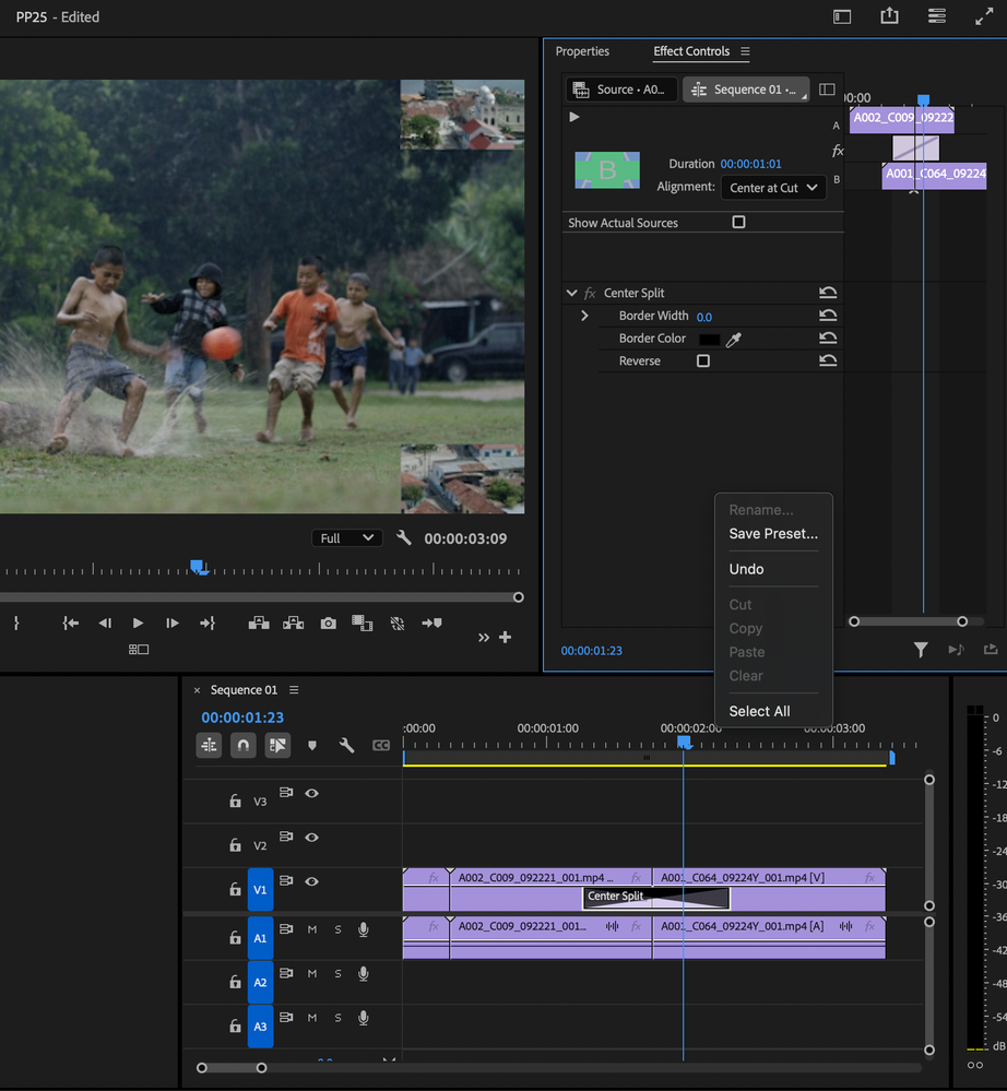

Mike Dziennik
October 28, 2024
Are you clicking on the transition itself? I dont have the cube spin effect but it works here with the Centre Split - it appears in the Effect Controls panel.
I was able to save the preset and then drag it as a transition between 2 other clips.
