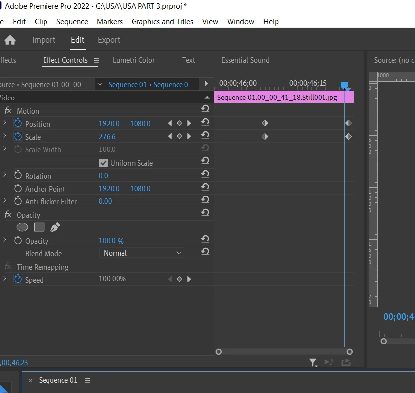

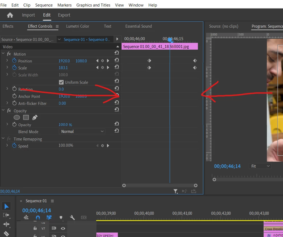

I dont understand the behaviour of Premiere here.
When I keyframe something and I move at the edge of the clip with the playhead,
it completely jumps over to a different part of the timeline (not even on the next clip)
and deselects the clip that I am working on. And I have to scroll back, select the clip over and over again and have to be really careful to work on the bounteries that I see.

Ann Bens
July 21, 2022
Dont move your playhead all the way to the end as that is not the last frame of a clip but the first frame of the next.
To avoid this behavior, go to the hamburger menu of the Effect Controls and uncheck Pin to Clip.
Now you can make the editing area larger with the slider at the bottom.
You probably also need to turn off  Selection follows Playhead.

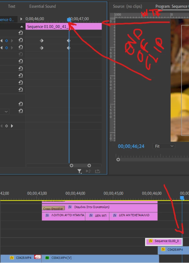

Ann Bens
July 24, 2022
That is not a videoclip it is a still. Total duration of a still is 12 hours. Hence no in or outpoint will be visible in the ECP.
